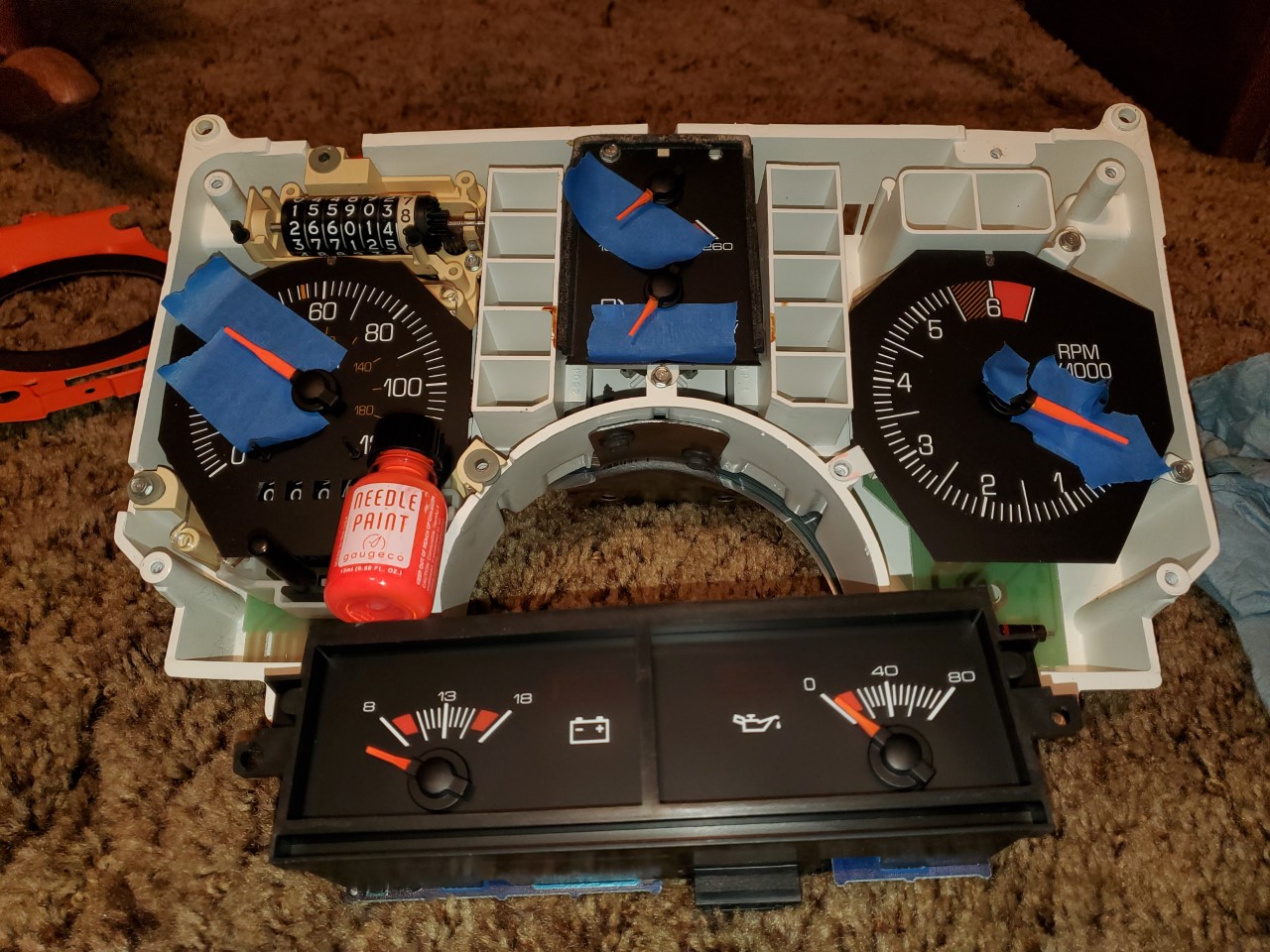

Decided to mess with the cluster now that I have everything working from half the dash not working. I went to white gauges on the web and ordered needle tint, gauge overlays, and the install kit. The I went to super leds website,and got 194 bulb replacements for the illumination. I had already changed out the other lights on the interior. They had an assortment of colors for the needle paint. I got orange.You can see it taped under the needles for spillage. But it did not happen.It was super easy to refresh and get the needles all the same color again. Some had faded to white,some not, one was nearly black and hard to glance at while driving. Do not remove the needles!!.

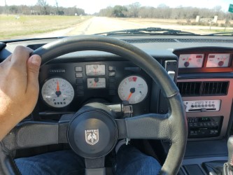

Then I applied the overlays,once the needles were dry. Also easy, just take your time. I then changed out the 194 size bulbs to leds. I found it matters which ones.Get the ones that look like the bulbs,with the same size glass cover.There is another one a few pennys less,but the difference in intensity is worth while. Then test drive time.

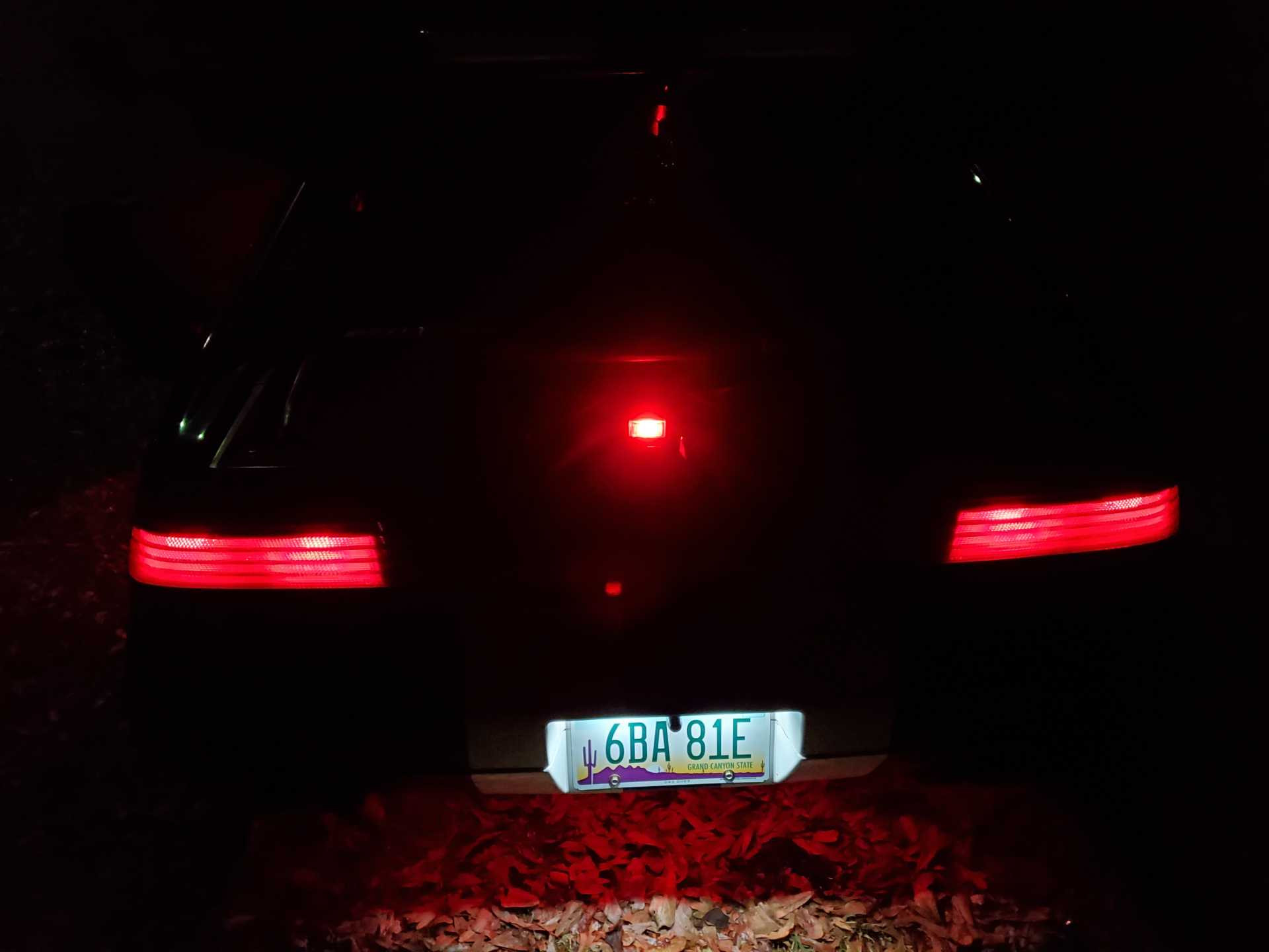

 After taking the night time picture, I adjusted the lighting down slightly, which made it easier on the eyes.
It is not require you pull the dash, but I did not mind, it was cold out,so I did the paint , overlays,etc, inside. For courtesy lighting, I used a 5 smd red led on passenger and driver floor illumination. Tried a smaller one first.Like the 5 smd led much better. In fact,I used those also in the overhead,in red. But used white for the two map lights, for clarity when reading or, who knows. Also replaced the rear trunk light with red .
Note: The leds polarity does matter.They fit in the sockets the same both ways, and both the sockets and leds are unmarked , and fit both ways in the board the same. On the first pass, 8 out of 8 on the main cluster, and 1 out of 2 on the center console cluster did not work. Thought I had a major electrical issue, and had the cluster half out again, before I thought to unplug a socket and turn it around. Lit right up ! Laughed at myself , and changed them all around to fully functioning.

needle paint came from white gauges, and looks very good. LEDs dim like regular bulbs. I was sure to get some good ones.Optimal comfort at 2/3 of dimmer dial. No pcm work. plug and play.Could not be happier[This message has been edited by gatorfrey (edited 02-21-2022).]
