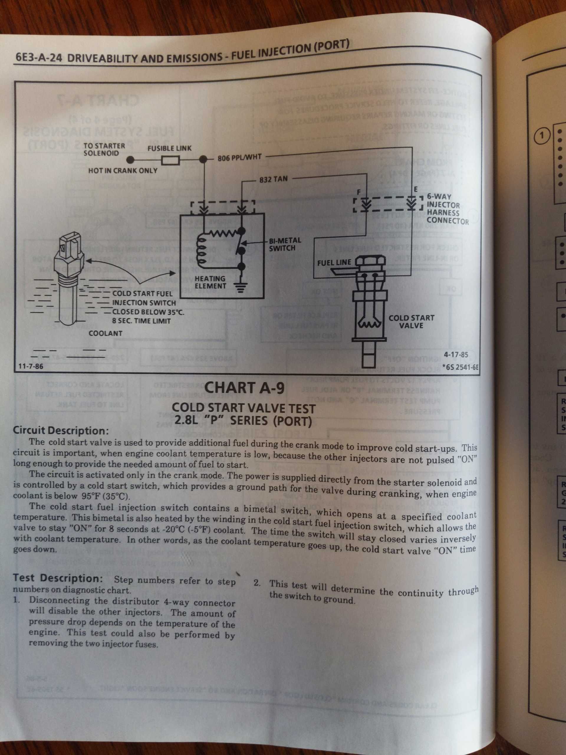

Still trying to find out if I am supposed to be getting voltage on BOTH pins to the cold start switch. ( I am checking during the first few seconds of cranking phase with the injector fuses removed )

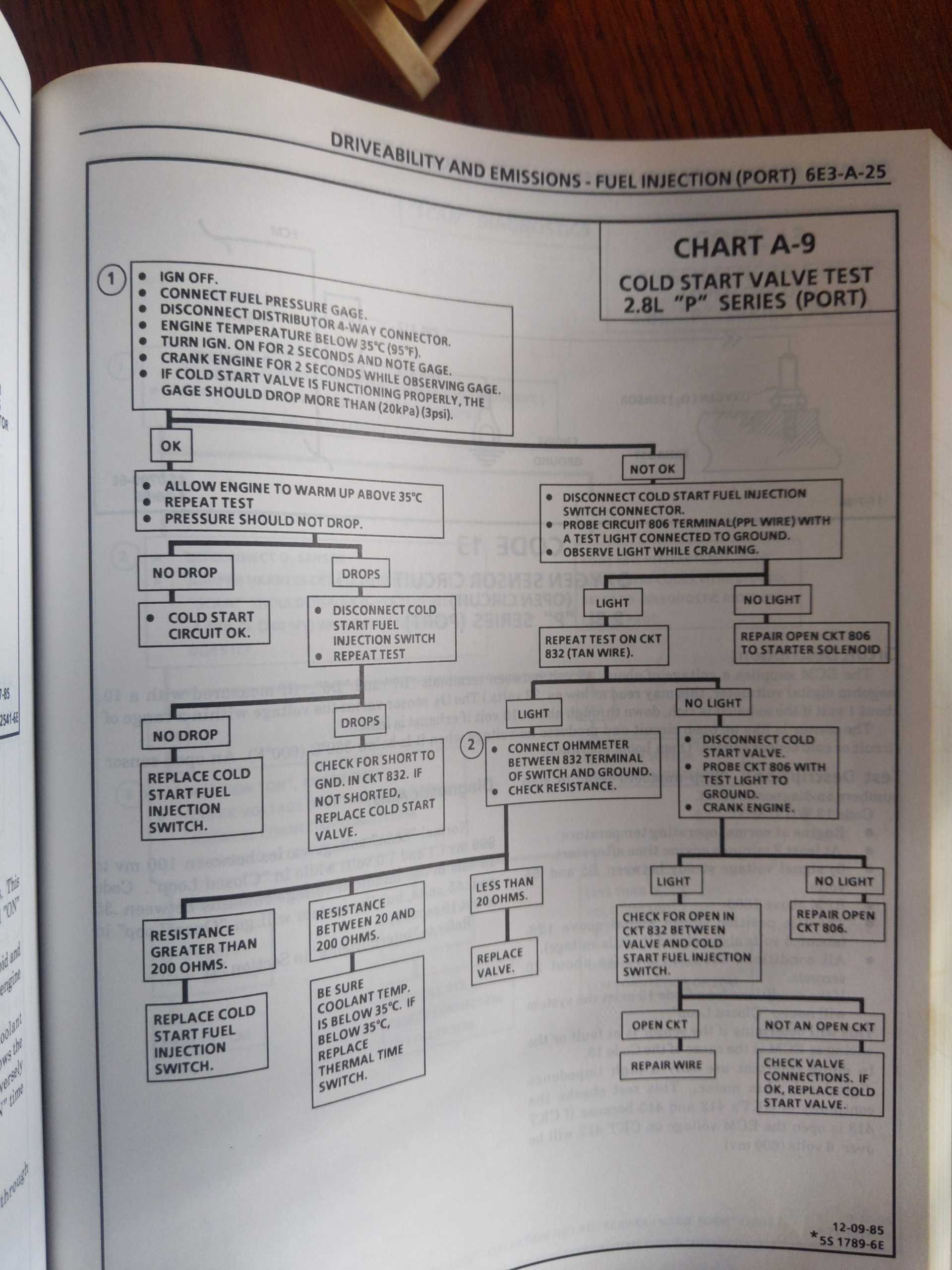

MAR 07, 05:01 PM
This is from the 87 Factory Service Manual.
Doug85GT
MAR 07, 05:14 PM
You will see voltage at both pins 1 and 2. If I am reading the wiring diagram correctly, the cold start switch is a relay. Pin 2 activates the relay that connects pin 1. Both should show power during cranking.
 [This message has been edited by Doug85GT (edited 03-07-2022).]
Rsvl-Rider
MAR 07, 05:27 PM
That was extremely helpful!
