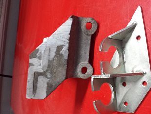

I found a pic but can't locate the ones showing the completed modification. I'll keep looking. This is the repair bracket you need to get from Rodney Dickman.
https://rodneydickman.com/p...o.php?products_id=63
I installed it with an offset to clear the crossover pipe. I ground down the factory ears that usually break like Rodney mentioned but I mounted a flat piece of stiff aluminum plate on that ground down surface first to give me a wider range for mounting Rodney's bracket further away from the factory location so the shift cables would clear the manifold crossover pipe. I clamped things together with vise grip pliers and did my testing and then drilled holes and used nuts & bolts with loctite to finish the project. Welding may work but I like to take things apart.
If I can find the pics you'll see its not difficult at all.
