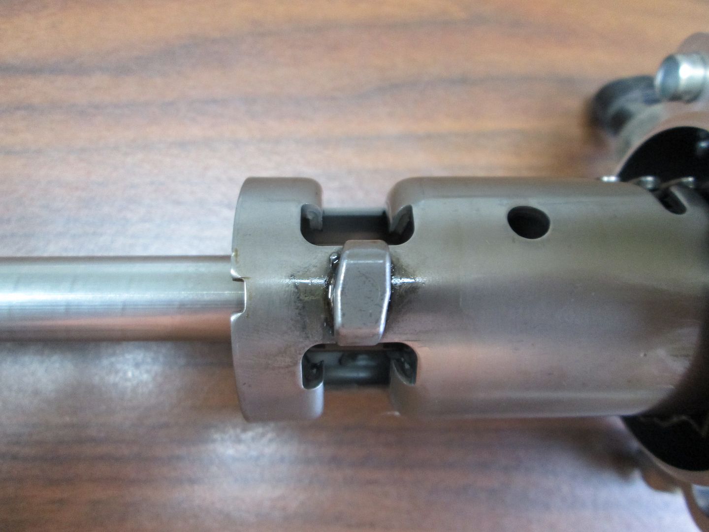

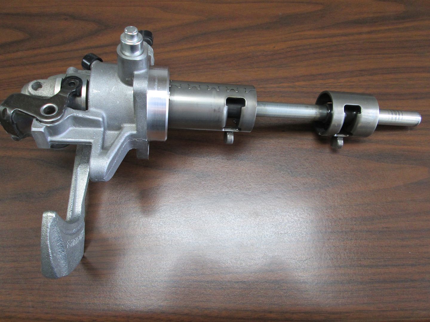

Here is an old post of mine when I pulled the shifter mechanism from the F40. Basically there are two tabs that engage and disengage the shift rails for both the upper and lower main shafts. The main shift shaft rotated forward and back to select Odd or Even gears. It is pulled/pushed into and out of the transmission case to access R, 1/2, 3/4, 5/6.
Speaking of shifters, I went ahead and pulled the one in my car for inspection, to better understand how it works, and look for options to streamline the 2-3 upshift. Just put the transmission in neutral, remove 3 bolts and pull it out.

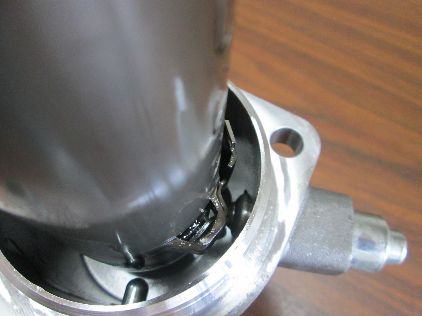

Within the shifter assembly, there is a pin that rides in a gated shift pattern:
There is a ball detent that helps to self-center the shifter in the 3-4 gate, but the spring pressure to go into the 1-2 gate is less than what is needed to go into the 5-6 gate, so the self-center feature isn't as strong from the 1/2 gate as I would like. Unfortunately, its cause by the countour of the bracket the detent ball rolls around on, so not an easy fix to add more spring tension.
There are two of these tabs that engage the shift rails. Notice they are tapered on one side. I might want to increase this taper (and angle the gate for the pin) to allow the shifter to start sliding towards the 3-4 gate sooner (when pushed from 2nd). I may also taper the edge that could accidentally tap 5th so I wouldn't hit the edge of 5th while trying to get 3rd.

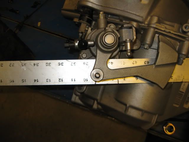

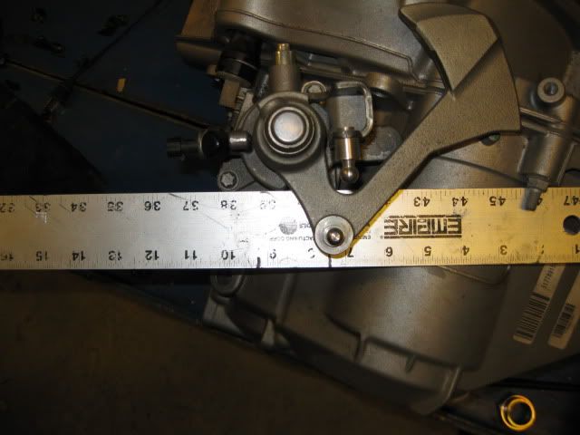

Here is another post that shows how much the ball end of the shift arm has to move to engage both odd and even gears. I never measured the other lever range of motion (or I can't find a post about it).
| quote | Originally posted by fieroguru: Since the Getrag Select cable only has 1 3/4" range of motion, I went and checked the needed range of motion on the F40 (the one for the 4.3) and got 1 3/4" as well, but I need to take it again in a more precise manner.

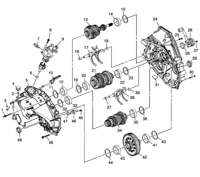

MAR 19, 08:24 PM

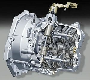

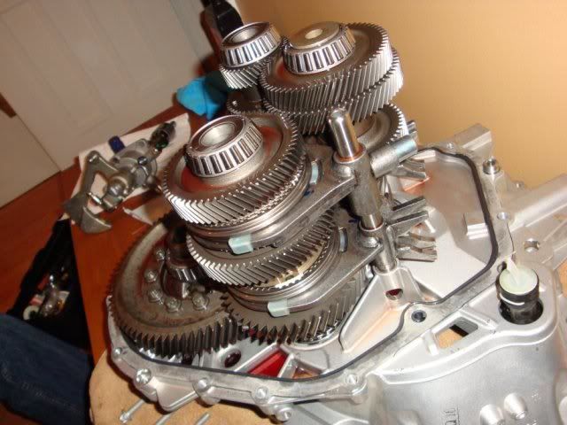

Here are a couple more pictures to show the dual sets of shifter shafts:
