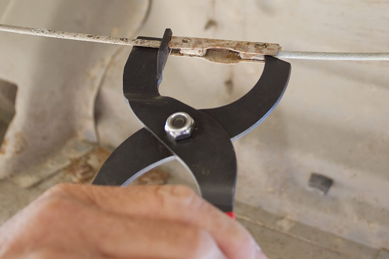

Joint... Grab center and 1 cable w/ visecrips with a little slack space then squeeze the pliers together. "needle nose" for center is best.
Note the metal joint has "Locking ears" that may need help to release the cable end.
But... You used a torch then part is junk. Likely the cables too because heating often screws w/ metal hardness and cause rust.

Ogre already posted an effective means of taking the link apart, if that's what you need to do, but when I was replacing my equalizer about a month ago I decided not to fight separating the link and bought this
 Lisle 44220 Emergency Brake Cable Release Tool
My link didn't seem to be too corroded, but this tool separated it for me in less than 5 seconds. With the link free, maybe it would easier to separate the rest.

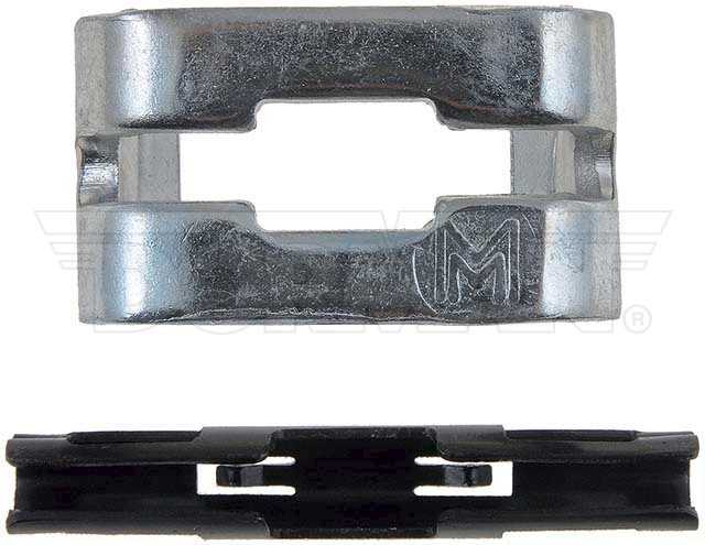

GM uses this: (Bottom one)
 Dorman Parking Brake Cable Connector 21126 Can see the small "Locking Ears" that often fight you.
Dirt, rust, etc make the ear a large pain. Can be make a so bend in more too. So may need small screw driver etc on the ears to tweak/clean them.
Tool above is good but many have visegrips and similar and works easy too and don't have to get a tool you rarely use. Shown in my Cave, Rear Brakes
But again... Heat Often damage this part and cable end(s) too. Does same for equalizer w/ the nut to adjust the P-brake...
