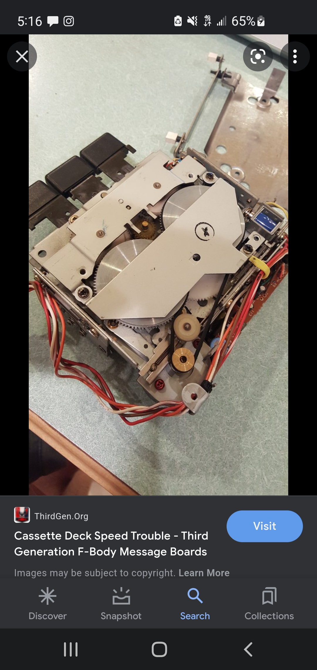

I believe you're right. I had the deck semi working but not moving to play the tape in the position I thought the switch was meant to be in, so I put it in the second most likely spot. I'll take it back apart and put the mechanism in the switch properly. thank you. here is an image I found online of the tape mechanism in my fiero.
