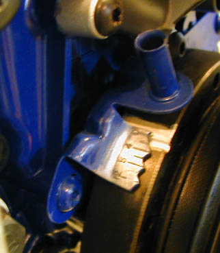

Which point on the timing marks do I use for TDC.
The one marked with blue or red?

I'll check what my deck lid says, I am not home. I just wish I knew what mark is what on this bracket on the crank.

APR 25, 08:40 PM
| quote | Originally posted by AfterThought:
 | | CLICK FOR FULL SIZE |
Any chance you're red-green color blind? (I had a friend years ago who was.)
I suspect the green mark is 0°... but the numbers will be inscribed on that scale.

APR 26, 06:50 PM
AfterThought
APR 27, 12:01 AM
Thank you for the picture!
I did end up setting the timing wrong, I was off by a mile. I needed to be at 8 degrees btdc. After setting that up it finally stayed running
After checking with a timing light i was still very off. Since the distributor is in a hard location to reach and line up it can be difficult lining everything up, for anyone reading this ALWAYS check your timing with a light.
