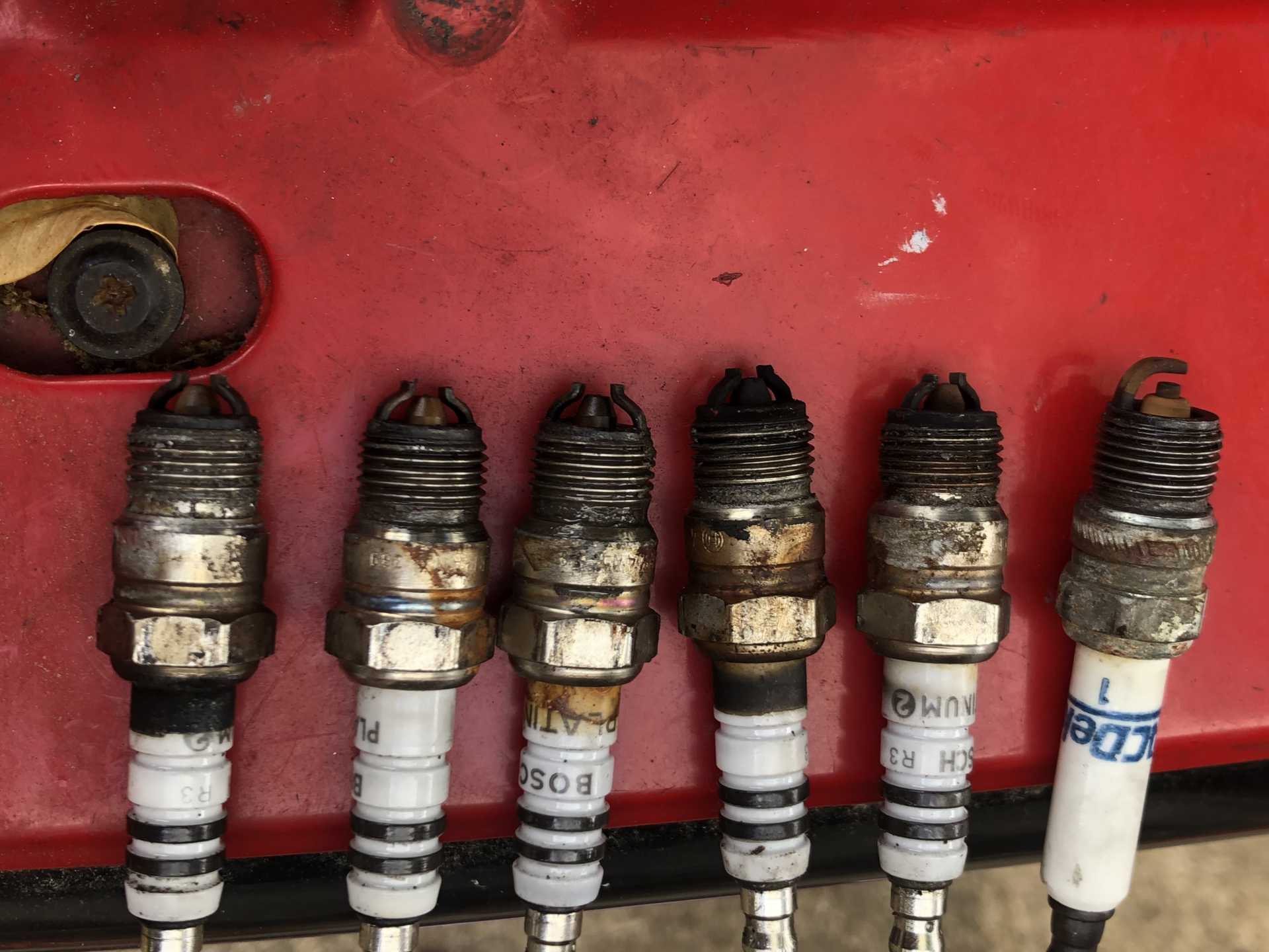

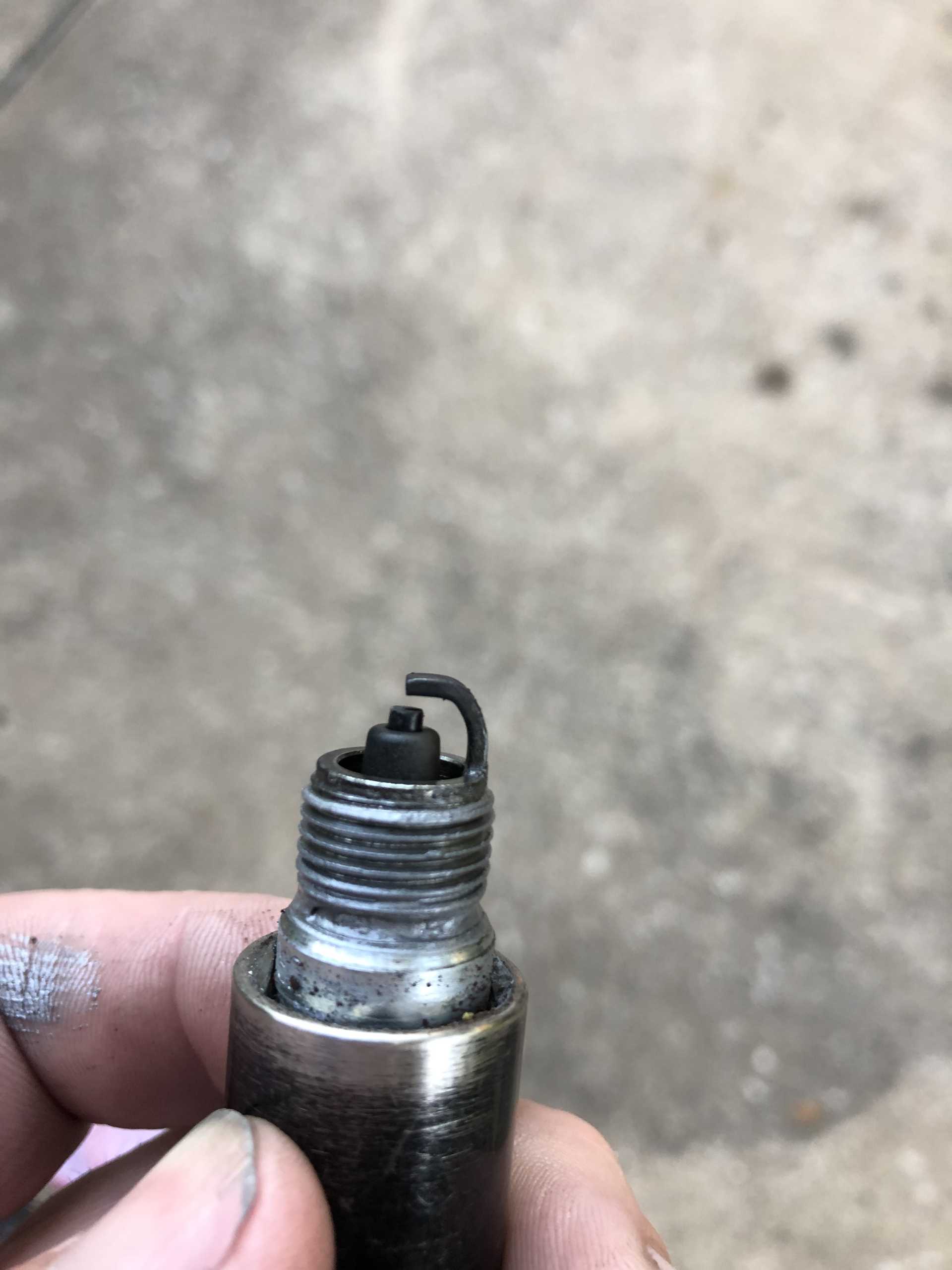

Did a lot of troubleshooting on the car yesterday. Got a new relay for the fuel pump. Car fires up fine now. Poor throttle response: I pulled all the plugs and put in new ones. Several were bad. Its missing for some reason...was before I swapped the plugs. I pulled cylinder 3 plug and there was no change in the engine. Checked for spark at the end of the plug wire and it is getting spark. Checked the injector and it is ticking. I recently put in new injectors...maybe somehow I plugged the wrong wire into one of the injectors. I would think it would be missing on more than just one cylinder if that were the case. Checked the firing order like 500 times. Its a head scratcher. I swapped out the cap just to make sure there were no issues. Also put in a brand new ICM as I always want a spare on hand (My sons 88 left me stranded cuz I didn't have a spare)

 Gap is good. This is a brand new plug... Rented a pressure sensor from Autozone just to check things. Fuel pressure is around 40...drops to 20 after some time. Guessing one of those injectors is leaking...or the coldstart one which I didnt replace....does not explain why cylinder 5 isnt firing... Did the ole screwdriver test and it is without a doubt clicking. I reckon I can replace the wires, but the test light shows its firing. I popped the oil fill lid and checked...I can see the lifters dancing. This is just weird. These are the old plugs

Could be injector(s) problems... Could be HEI problems... One iffy plug, plug wire or cap/rotor can cause intermittent problems. Even iffy pickup coil ICM etc can do that. Worse Both.
Burn oil and/or running way rich often carbons the plugs and carbon basically shorts out the plug trying to fire.
Avoid "Gimmick" plugs even Bosch multi grounds like above. More so if burning oil or running rich.
