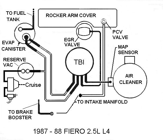

Check your vacuum lines. Bad idle on these has always been bad vacuum for me

If I am correct, it only needs the map sensor to run and all the other lines can be capped?

Uhh That would disable cruse control if you have it and bypass evap and probably cause some issues with the evap system. Never heard of someone doing this. Also you have to have vac to the EGR.

Blocking vac lines can cause other problems. Like ERG need to work or engine get can miss during accel and other issues. See my Cave, Vac Leaks
