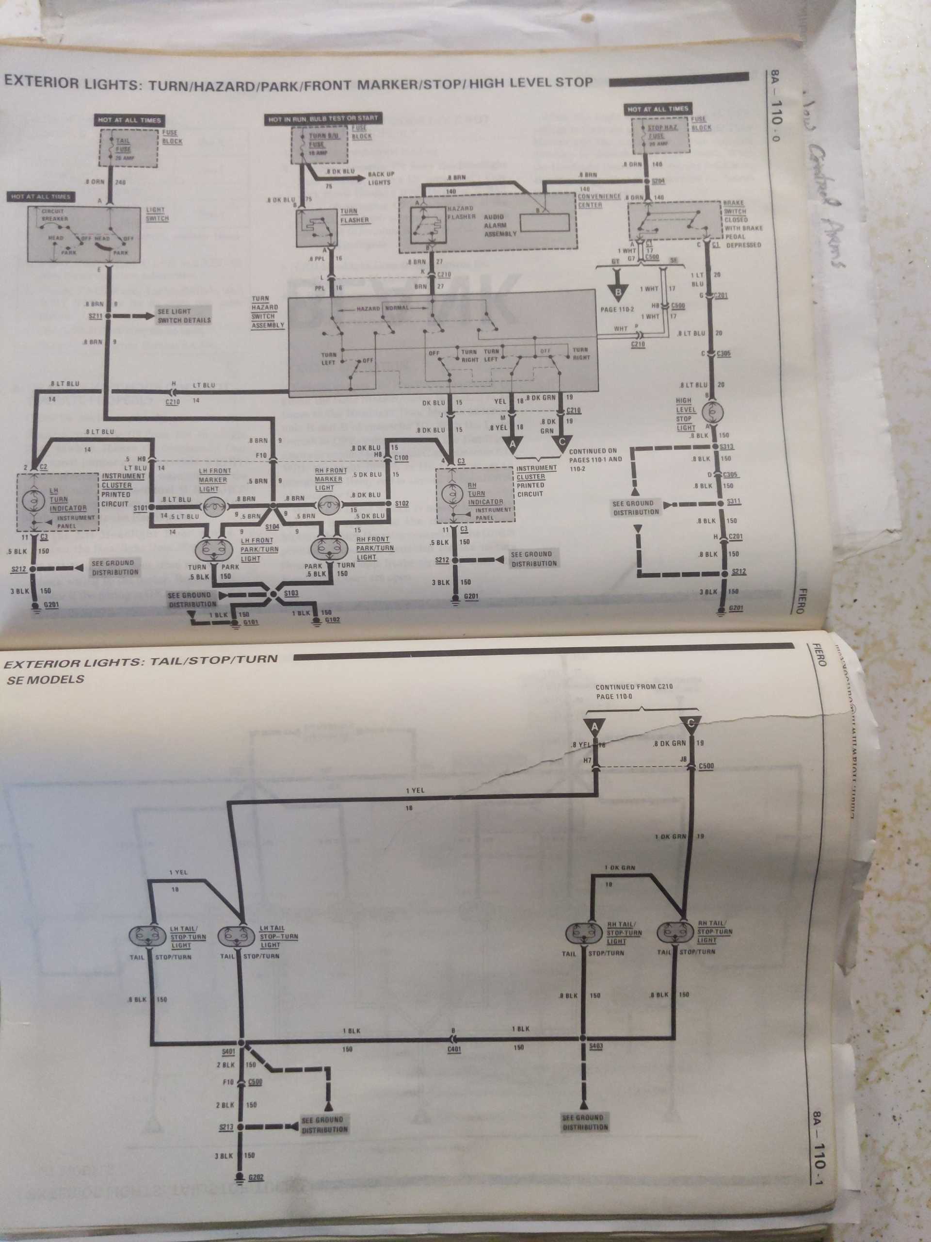

I would look at the Turn/Hazard switch assembly.
Here is the diagram.
The high level brake light is on its own circuit through the brake switch. The brake lights on the rear of the car are routed through the Turn/Hazard switch in the steering column.

Thanks for the replies! It's definitely the turn switch. Moving it around caused them to flicker and switch back and forth to staying on.
If I get it in the right place they both go off.
I'm guessing the best thing is to jut replace it.
