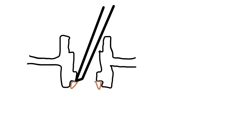

It's not going to help this time, but if you have a die grinder with a carbide burr, I recommend carving out two notches in the step the race seats on. This will give you a nice large access to drive out the next race.
This time, a semi-wide punch with a sharp edge is the best thing.

Thanks FieroJimmy. I've got a Dremel die grinder, but hadn't thought of what you suggested. I'll give it a try.
