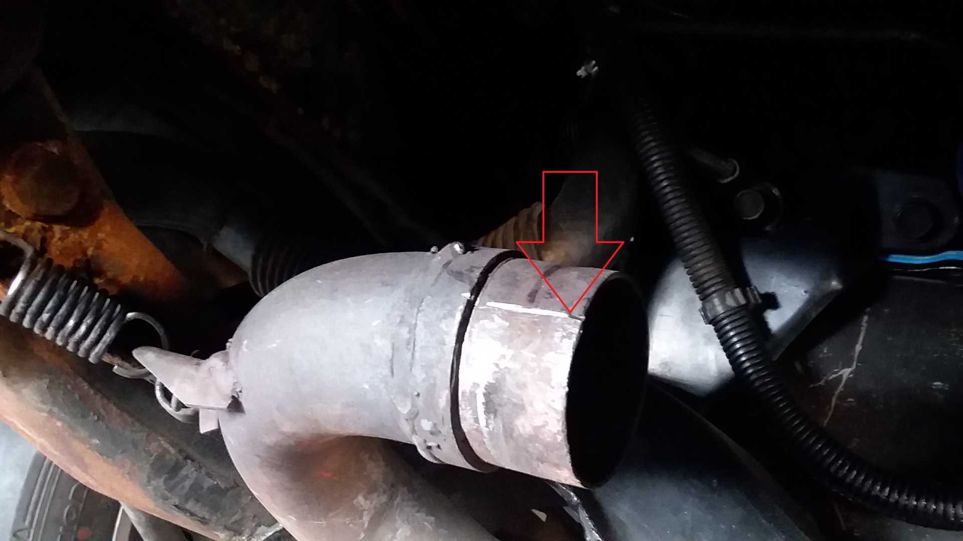

Ok, so,in cutting the old cat off (turns out it was NOT the OEM unit) I managed to scar the pipe surface that the new cat will clamp onto. If you look at the Red Arrow below, my cutter almost penetrated the wall where the arrow starts on the Right and gets shallower going towards the Left, where it peters out such that you can barely feel anything has happened to the surface. Do folks think I should apply an Exhaust Sealer of some sort there, just to be sure there won't be a leak??

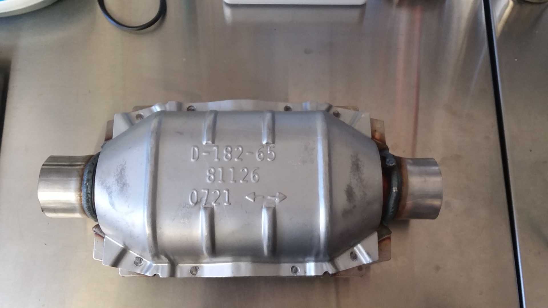

Also, looking at the new cat below, I'd like to confirm that the Double Arrows indicate it can go on either way (i.e. there is no In and Out) and that the side with the Heat Shield gets installed toward the Ground, yes?

How did you cut the pipe?
Notorio
MAY 17, 10:01 PM
| quote | Originally posted by hunter29:
How did you cut the pipe? |
Dremel with cut off wheel. Really worked well.

...and that the side with the Heat Shield gets installed toward the Ground, yes?
Only if you're concerned about melting the pavement.

Note: When using exhaust clamps... You slot the outer pipe. GM FSM and more tells you this but no-one looks. GM say 2 slots but I use 3 small slots 120° apart. Even before exhaust cement, the clamp forces the slot to closes.

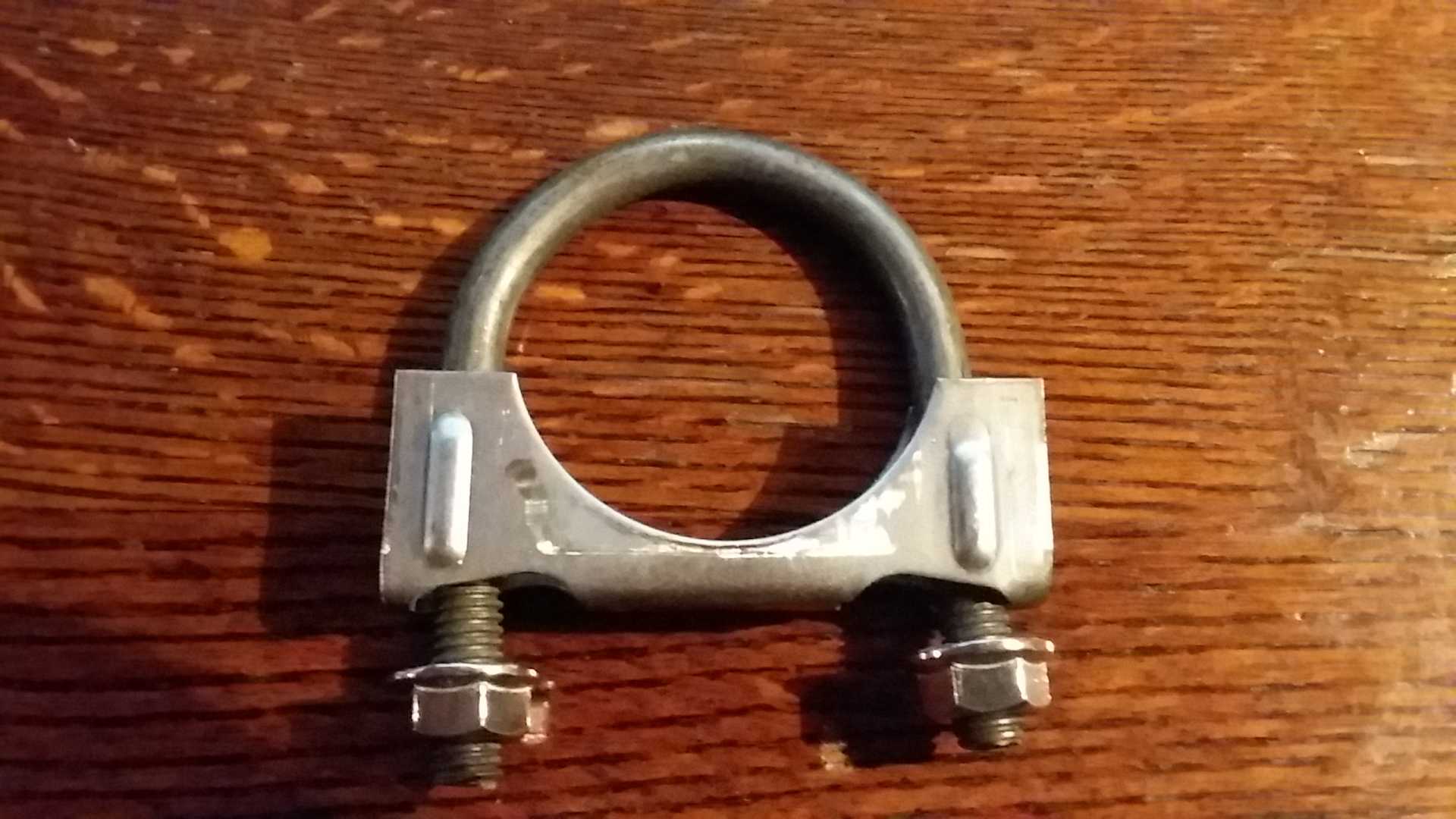

If your stuck w/ "cheap" clamps, any like the pic, use 2 180° and very close to each other. This gives enough force w/o bend/breaking the clamp, strip threads, etc. You need that because hanger springs and heat cycles want to pull the joints apart.
That's interesting because the old cat had the shield toward the ground --- I was thinking that is to protect against starting fires parking over leaves, etc. So, shield goes Up to protect the car.

Ogre, I never heard about the business of slotting the pipes. If the old non-OEM cat had been slotted I can see that it would have been much easier to remove. How long do the slots need to be?[This message has been edited by Notorio (edited 05-19-2022).]

The SS clamps supplied by TFS look and feel really sturdy compared to what I took off the old cat. I like how the nut mating surface is canted to pull the clamp ends inward.

| quote | Originally posted by Notorio: Ogre, I never heard about the business of slotting the pipes. If the old non-OEM cat had been slotted I can see that it would have been much easier to remove. How long do the slots need to be? |
Is kind of a guess depending on clamps used and how close the pips fits. In general, I cut the slots just long enough so the clamp, or 2, can work and close the metal too. But last time inner was smaller and had more play so cut a little longer slot w/ HD wheel.
