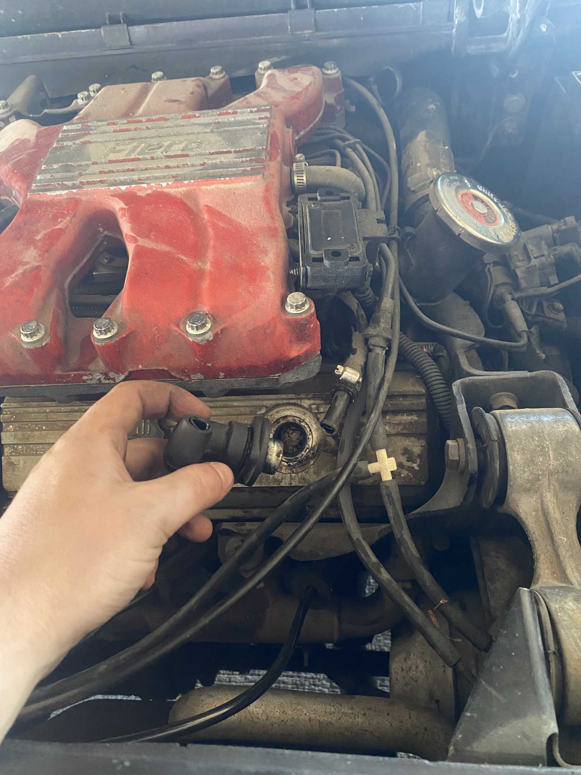

Hello all, was doing some work on my 85' gt and ended up snapping the pvc valve hose and was wondering how I go about fixing it and if needed what I would all need to replace everything.  [img]https://images.fiero.nl/userimages/PapaTrig24/B81D0C26- 2330-4FBE-820F-E30B4C7B4247.jpeg[/img]

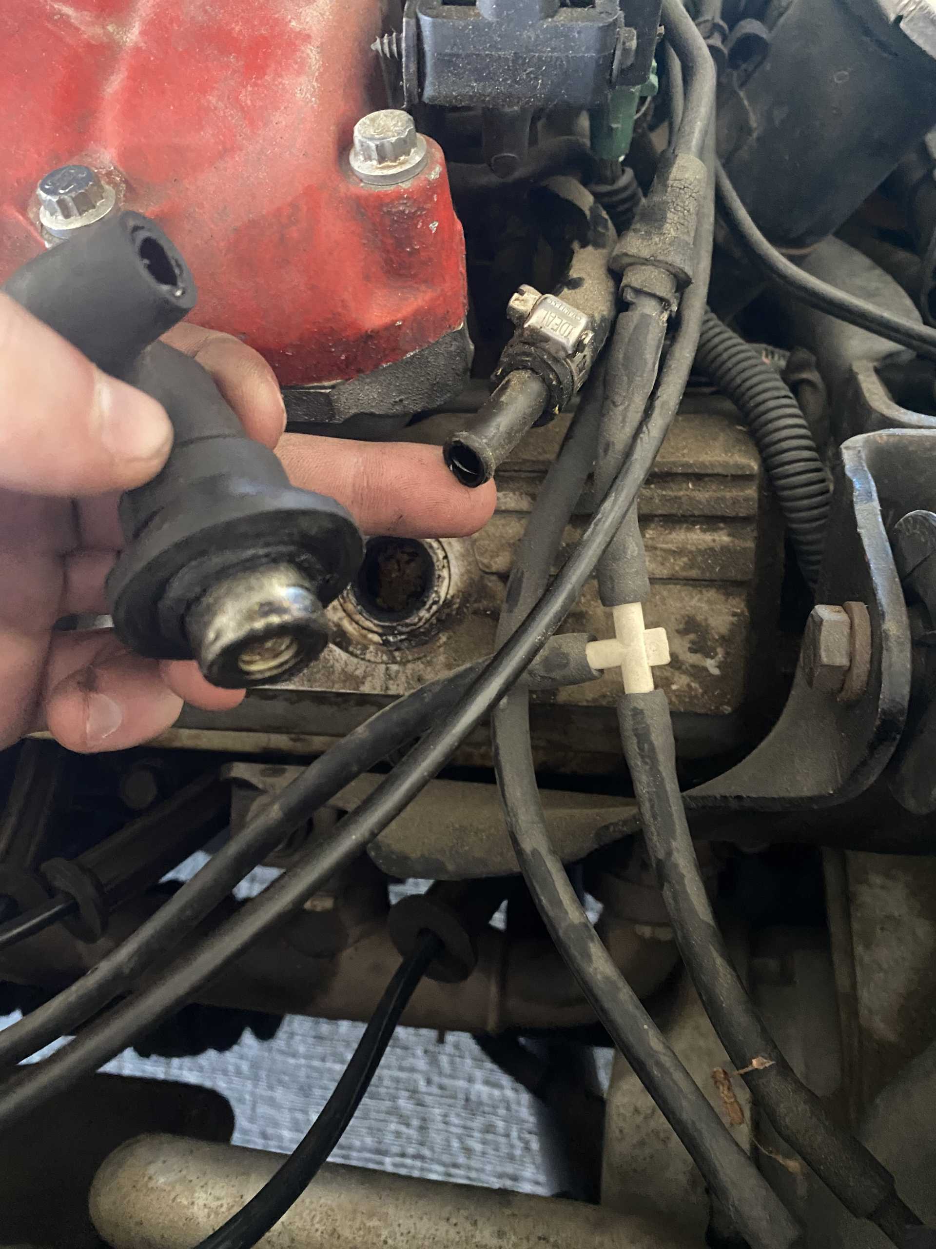

You have some previous repair work to clean up. The hose clamp is not stock, and the broken tube should be removed. The vacuum tube that is needed is available in a set from the Fiero Store, and perhaps other places.
You will not damage anything if there is no PCV, but everyone will thank you for the clean air in 29 palms....  [This message has been edited by Gall757 (edited 05-22-2022).]
