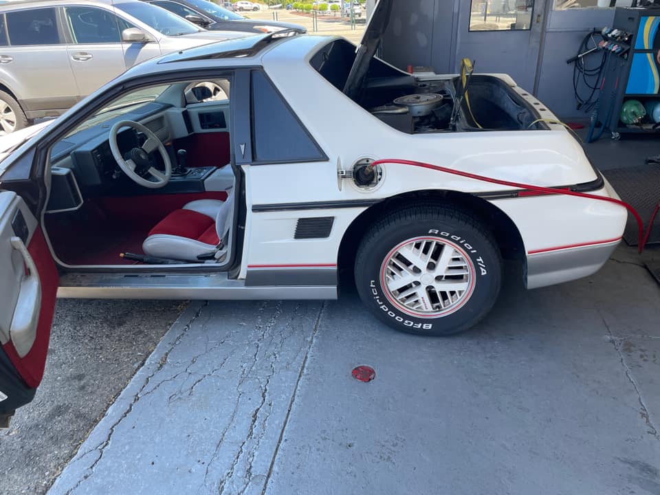

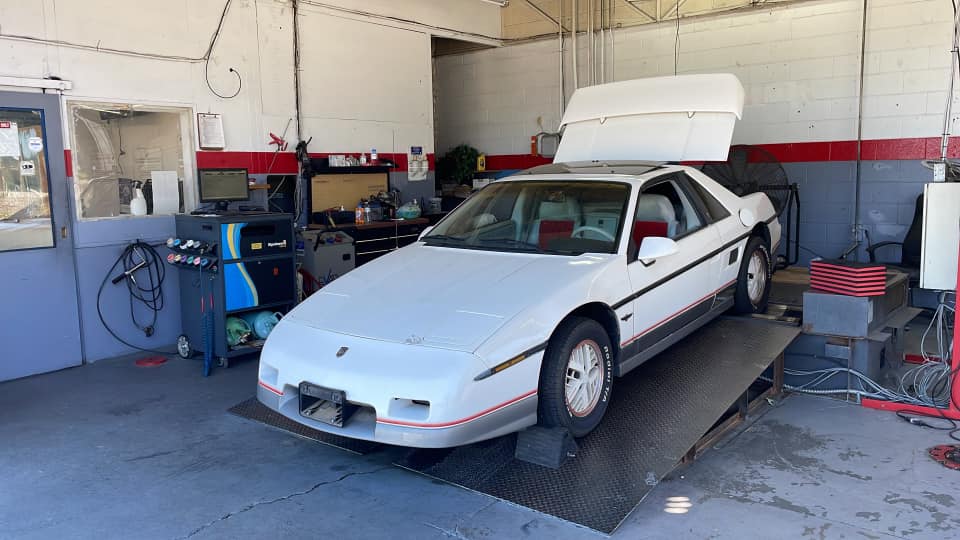

In any case, during the recent SMOG certification (California), the tech said I was edging on a bit dirty which he attributed to bad gas and mentioned my timing was at 11 degrees.

By the way the SMOG Tech said he has seen two Fieros in ten years! I had to help him with the timing as he had no clue where the ALDL was. Nice, patient guy that I will have to drop a 12 pack on because smog testing the Fiero took over 2 hours with the assorted tests. Cars from '78 to '95 get put through a battery of tests. Personally I have no issue with them if it keeps the air breathable, but apparently some SMOG shops prefer to say their EVAP machine is broken so as to avoid those cars that require them. Which brings me to the EVAP canisters. If you are junkyard diving, you may want to save EVAP canisters that fit which appear to be a large swath of 2.5 and 2.8 GM cars from 84-88. No one is selling them under any brand.
