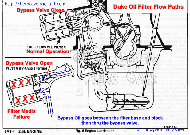

| quote | Originally posted by armos: I get 60psi cold, which I believe is where a bypass valve opens. |
No. Bypass Valve, in Many GM is in the Engine where Filter Flange is, only open when input to and outlet from the Oil Filter is > ~ 7 PSI different. Oil too thick to flow thru the filter, bad/drity filter media, and some other setups can open this valve but you don't want that open. Not only does Dirty Oil get in the engine, Bypass valve often doesn't flow enough when have filter problems.
Example:
Filters With Bypass Valve work same but set point to activate it can above or below 7 PSI. Most are at the Top of the media and often harder to see. See https://www.youtube.com/watch?v=-Fy-G9t0jPs
