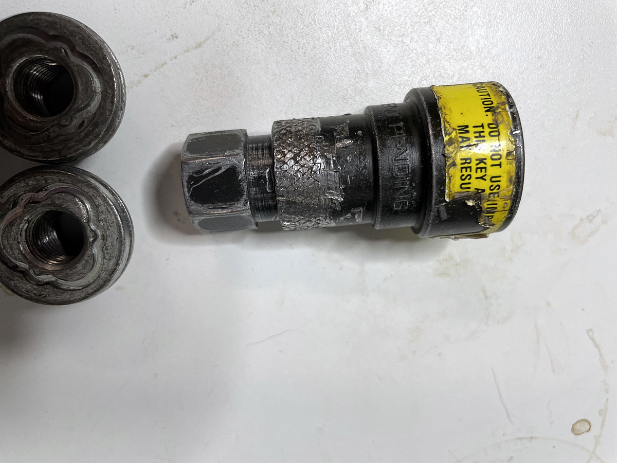

After about 45 minutes, I get a call from the Costco Tire Center from the tech who starts telling me about how I will have to take the tires off because he can't get the key to work. So I walk over to the shop and this jerk starts showing me how the key spins and he can't get it to suck into the bolt, and that since the last time the car was serviced was at install, he wasn't going to work with these "old, broken locks".
Looking down at my car, I see the air impact hammer and my lock and ask him if he can read? I also ask him if he uses an air impact hammer on all his customer's wheel lock keys? I think I called him an idiot as well. Then he tells me to "Calm down", which lead to a quick dismissal of any further conversation and a visit to the manager's office.

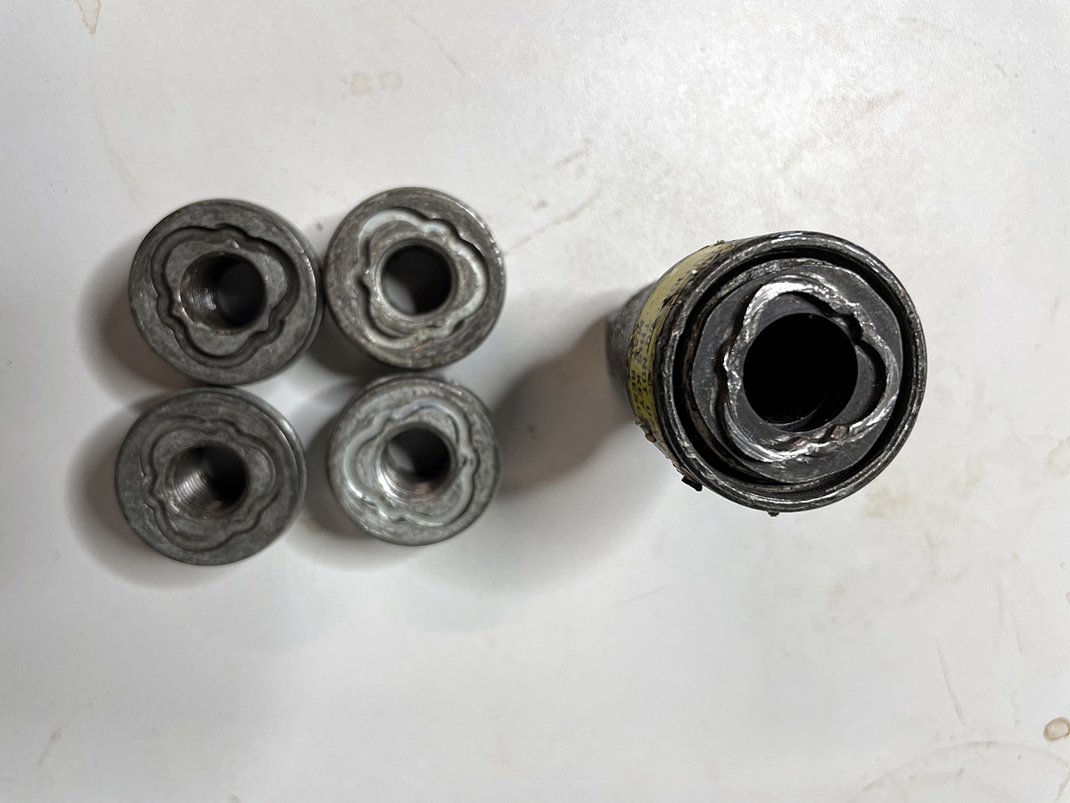

After futzing with the car with the Manager for a few minutes, we decided the idiot has probably destroyed the key by not screwing it down properly and then compounding his stupidity by using an air impact tool when the key clearly says not to. (OEM key and lock, big yellow tag that says, "Don't do it".
I take my car home, get my 1/2 drive with the appropriate socket, a mallet, a vice grip, a can of penetrating lube (just in case), and an old rag. Within about 45 minutes, I have all the lock nuts off without any hammering, drilling, or curse words. None of the lugnuts took extraordinary effort to remove, including three of the four locks. The lock the idiot was working on was cross threaded, but I was able to mallet it past the damage, and then crank it down with the vise grip. (I used the rag to keep the vice grip from accidentally scraping the paint on the stock Indy wheels.

Today I call McGard, the provider of the OEM spring-style keylocks that the 84 Indy left the dealership with. The good news is that IF the idiot had not trashed one of the locks, they could have sold me a new key. The lady I talked to, gave me a direct email to send pictures and she called me back within an hour! The downside is that they do not make the lock lugnuts any more. Instead she recommended a set of locks that were black and about the same length as the lugnut/plastic cap combination. They will be shinier, but also come with a key that FITS OVER the lug nut which will prevent slippage and wheel finish damage.
