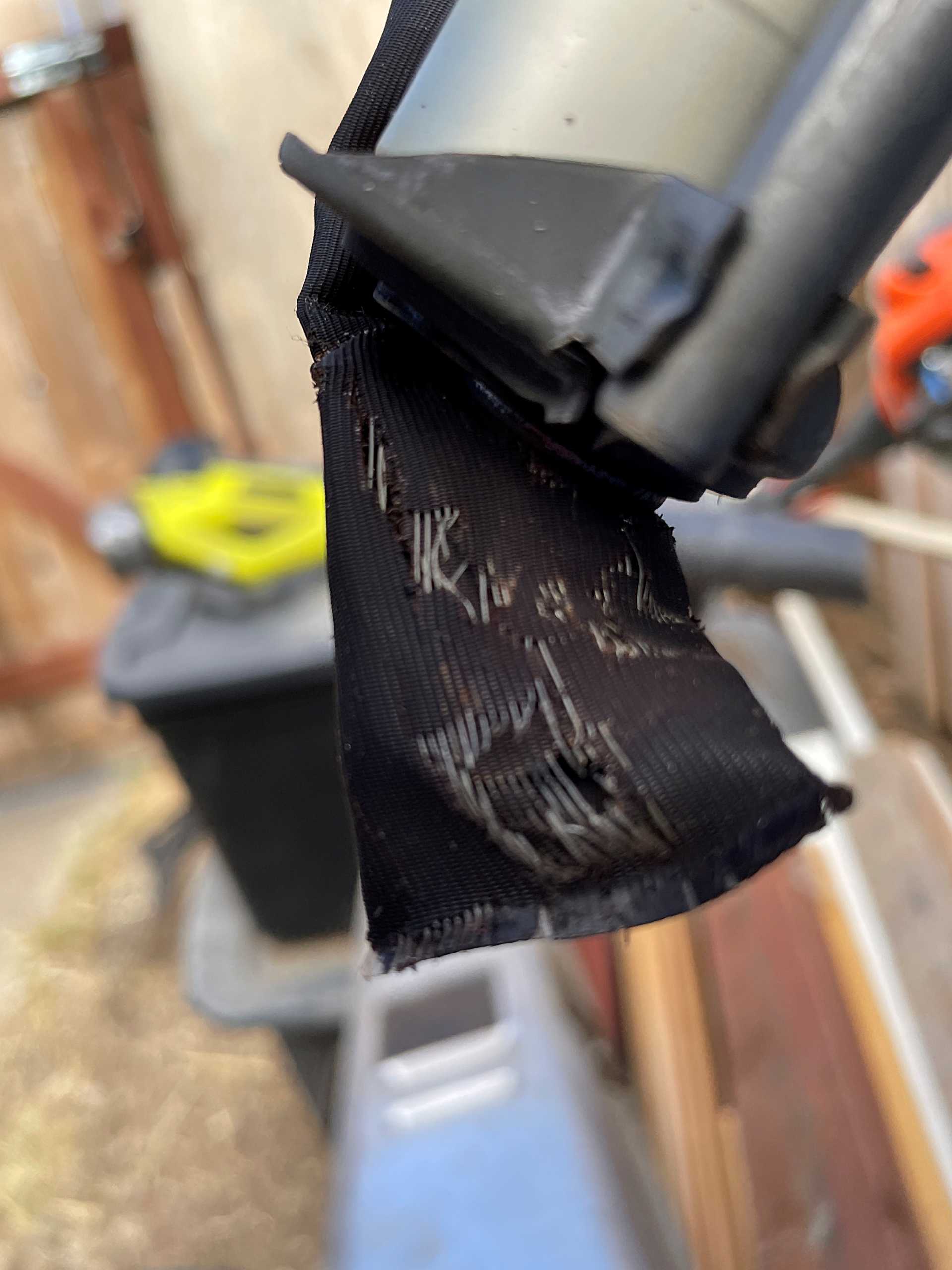

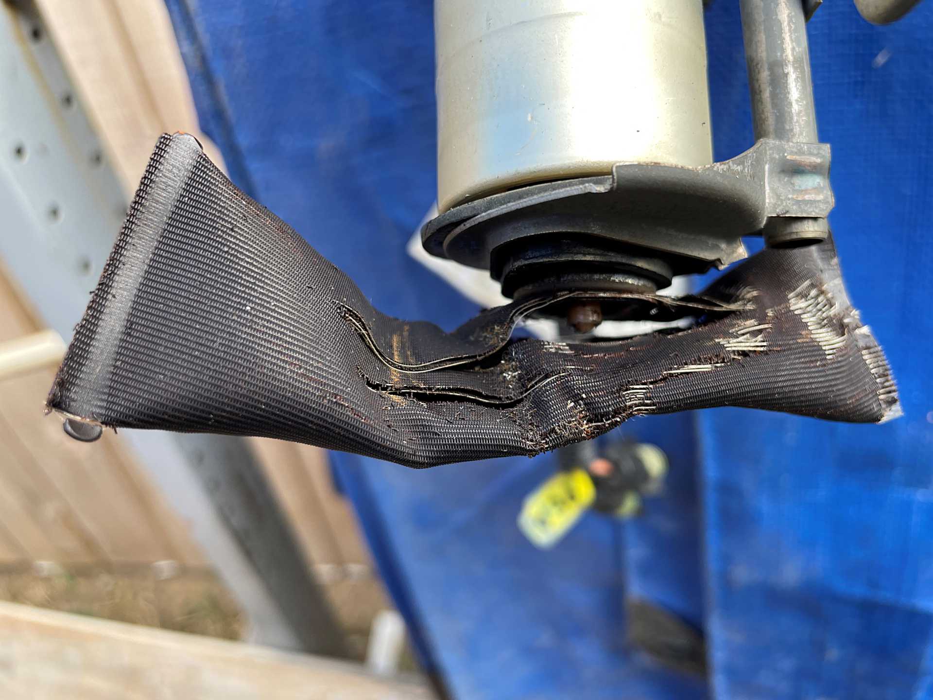

In this case, after pulling the tank, I was amazed how clean it was. Just a few small pieces of debris that may have been a random piece of vegetation. The heat shield was another story. There was a wealth of organic material trapped up against the engine firewall. Awesome tinder for a fire packed up there. The tank was pretty clean, just a few floaters which I filtered out when draining the tank. The strainer came apart immediately while it was still wet. It had holes in it. Once it dried, it crumbled. So one way or the other, I was going to have to deal with the fuel pump/strainer. Better on my terms, close to home. Years prevail over mileage. As it came out of tank before touching
 After some exposure and a gentle touch
