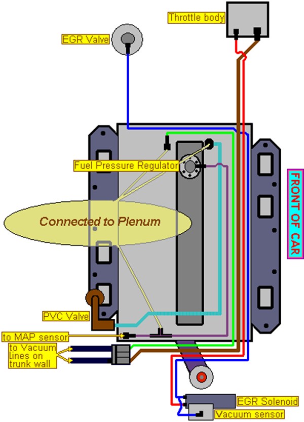

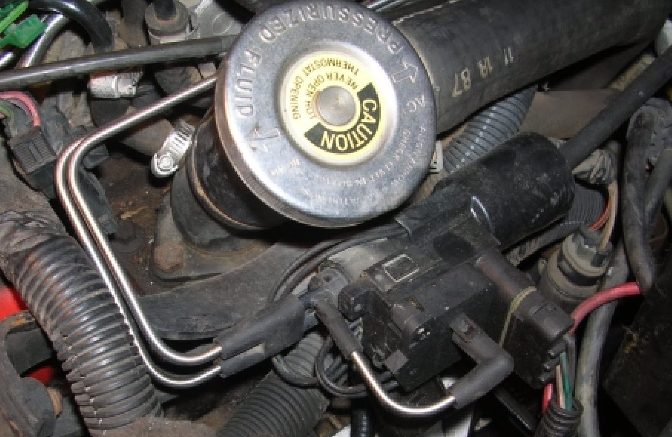

Hey IMSa GT, can you do me a favor and post a pic of the area I’ve circled? I know I don’t have the correct hose connection but have never found a good reference photo

quote | Originally posted by jwalker:
Hey IMSa GT, can you do me a favor and post a pic of the area I’ve circled? |
This is the vacuum routing for the 2.8. This was drawn by one of our members, Buddycraig to make it easier.
This is another picture but with a stainless steel line upgrade.
