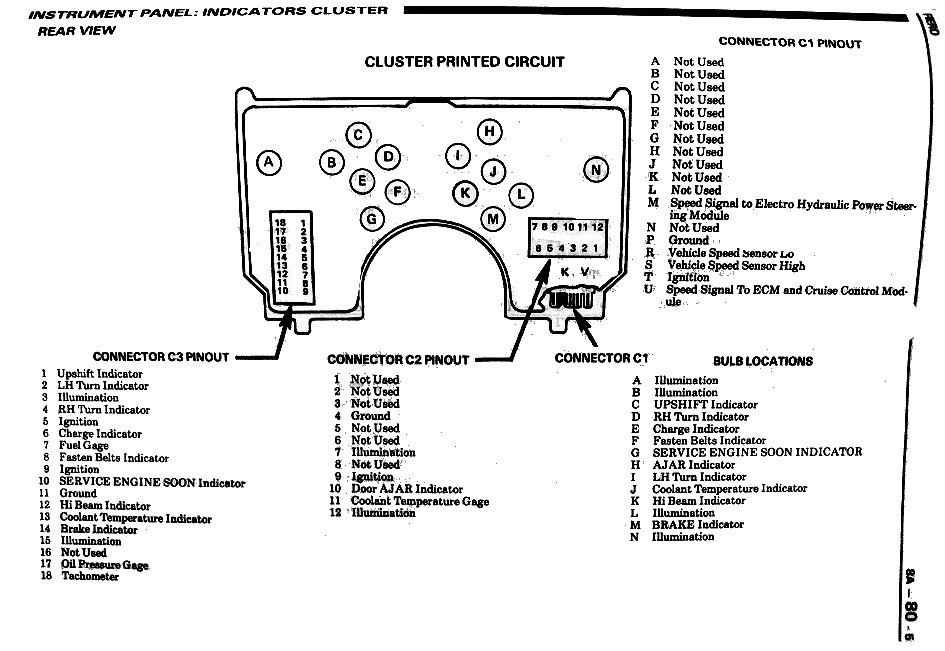

I dont think the dummy light is meant to come on until 230* and by that temperature damage has already been done. But, if your gauge says 195* and the digital thermometer says 198*, safe to say the gauge is correct and the car is operating in the correct range (stock thermostat temp is 195*).
As you can see, there isnt much else going through that C2 connector. It is puzzling how it is 'half on'. I would check if that C2 connector is loose, or wires are frayed and causing current to jump over, completing the circuit and illuminating the bulb. Maybe power from the door ajar light is crossing over? I would test resistance between pin 11 on the C2 connector, and every other pin. they should all be open and if there does appear to be resistance between pin 11 and another, it means current is crossing over from something else
As Patrick said, test resistance between pin 11 on the C2 connector (overheat light) and the main engine ground. then, you will see if it is grounding properly
