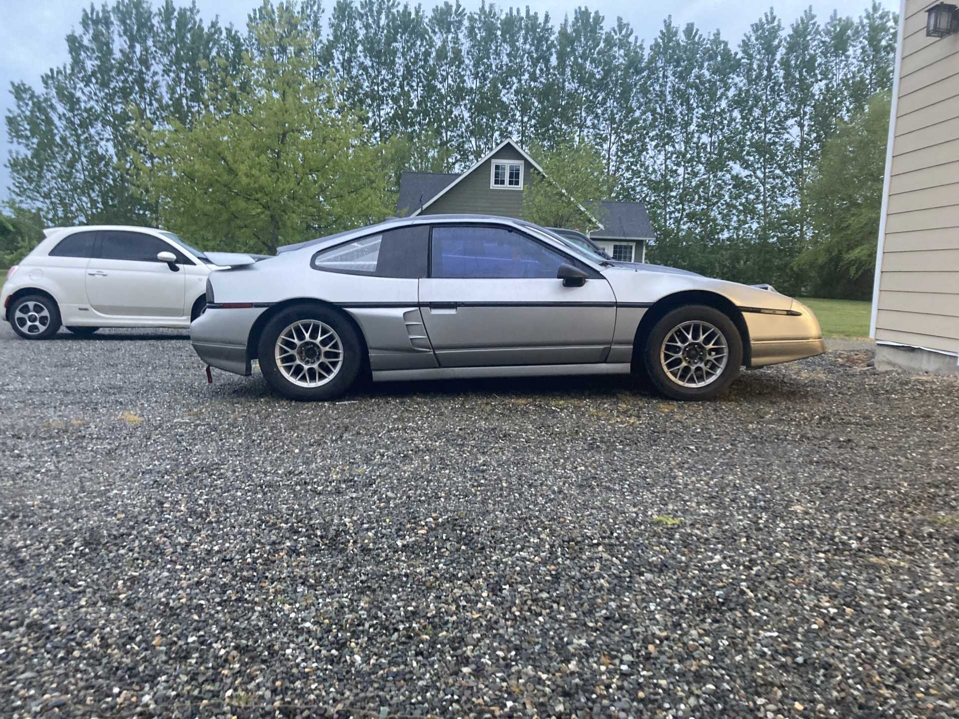

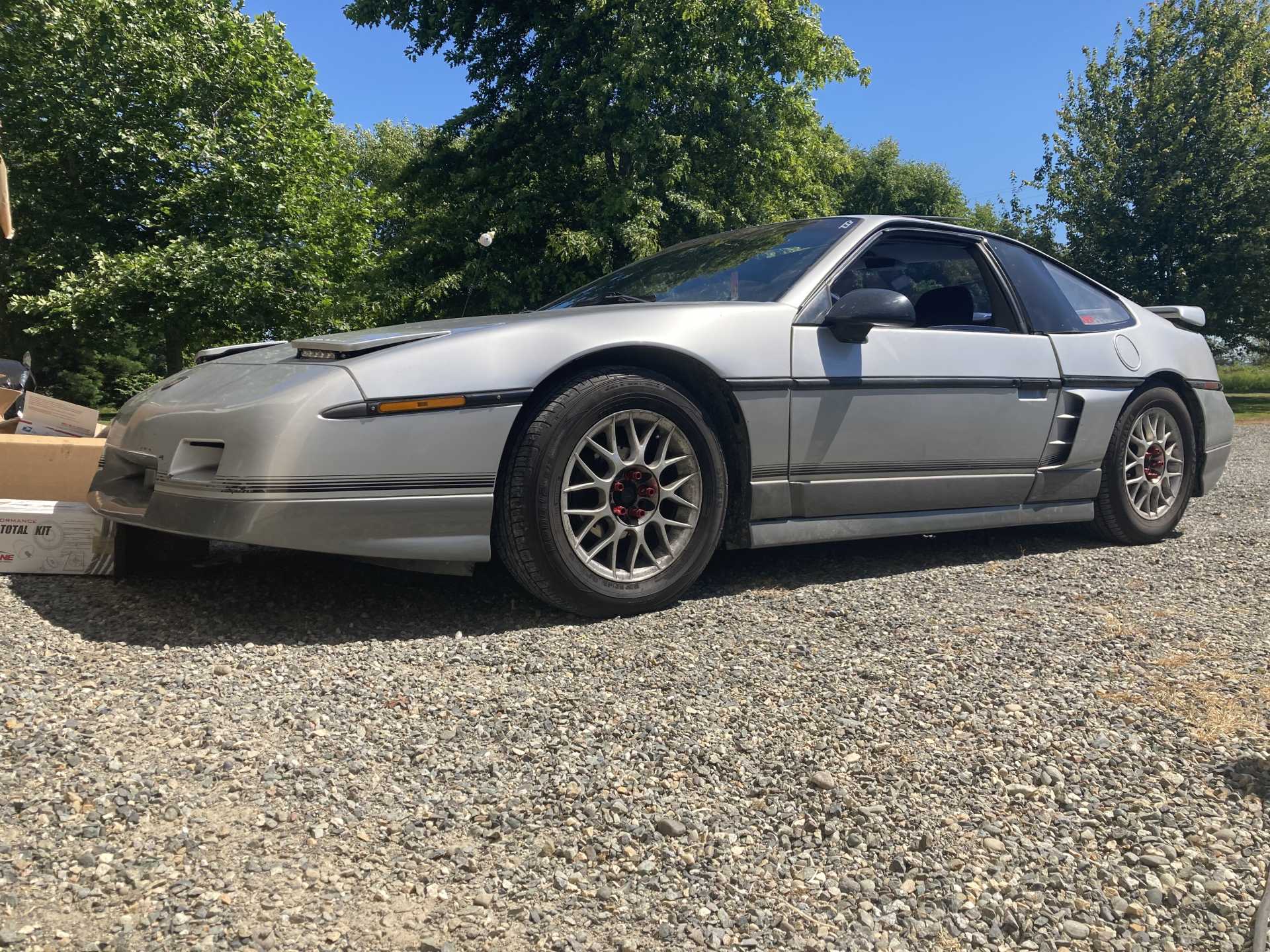

Howdy. Sorry if this is a really stupid question lol. Last month I installed 1.5" WCF lowering springs and Rodney Dickman 0.5" lowering ball joints (and brand new KYB shocks) in the front of my 86 Fiero. Install went smooth, but it seems like I'm not getting the full drop like I should be getting.... To my eye, it looks like only the ball joints are doing anything. The springs are physically shorter than the stock springs I ripped out, and it's sitting in its perch just fine. It's also not riding on the bump stop and I can still feel some suspension travel when driving.
Is there anything I'm doing wrong? Or are my eyes deceiving me?
Before
After
Thanks!
AUG 08, 10:20 PM
The front looks to now be lower to me... and it'll probably settle some more with a bit of use.
| quote | Originally posted by imjoeking:
If you didn't shorten the metal cones, you're liable to be in for a rough ride when the lowered front suspension bottoms out over bumps.
It might be an optical illusion, but in the second photo, the top of the rear wheel/tire appears to be leaning outwards.[This message has been edited by Patrick (edited 08-08-2022).]

yea now that I'm really looking at it, I probably am getting the advertised drop. I must have lowered my rears more than 2" and didn't realize it so it looked weird to me ha ha.

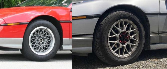

Somethings not right. Here is a stock 1986 and your car compared.
Are the springs rotated in the seats correctly? I think you should be WAY lower. Also look at your pictures and the top of the tires in relation to the black belt line. It even looks like the passenger side is higher than stock.[This message has been edited by IMSA GT (edited 08-08-2022).]

The new rubber isolator on top of the spring will cause the car to raise vs. before. It is the old one will be more compact, which would have lowered the car some.
Other likely common cause is the end of the spring is not in the formed pocket on the lower a-arm. This will cause about 1" or raised stance if not properly seated.
IMSA GT
AUG 09, 06:44 PM
| quote | Originally posted by fieroguru:
That's what I was thinking. The end of the coil might be on a flat spot of the arm instead of seated in that recessed ridge.
imjoeking
AUG 09, 08:15 PM
Bingo. I managed to put them on the completely opposite side. Currently fixing it! Will update when it’s all back together
