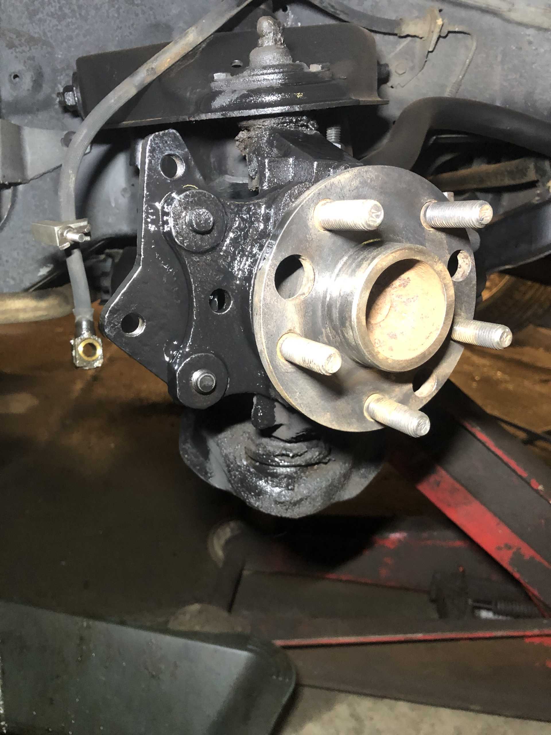

I do not have any data on my brackets, I prototyped them using Hardwood until I got what was for me, my optimal caliper placement. From there I took the hardwood bracket, a spindle, a caliper to a machine shop and had them finalize the bolt spacing and recreate them in Steel brackets. This was many years ago now, I have no clue where that Hardwood buck even is anymore.
The Main body of the caliper clears fine, it's the Boss for the flex hose and the flex house bolt is where it gets tight. As olejoedad said, some grinding may be all some brackets need.
All I can provide you is a picture of my bracket installed, as you will see you don't have to push the caliper straight back, some creative re-clocking is all that's needed.

Thanks, it may just be that the brackets I have will work for me with some creative wheel grinding. We will have to try it and see!
