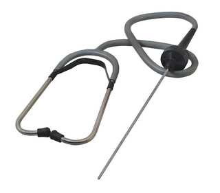

I don't know if it's the "best" way, but you can use a mechanics stethoscope with the rod attached and touch/listen to each injector to make sure it's clicking.

The stethoscope is a good idea Patrick. I need to do some more reading on how to test/fix injectors if that is my issue.

AUG 15, 05:49 PM
If you haven't got one... get one!
