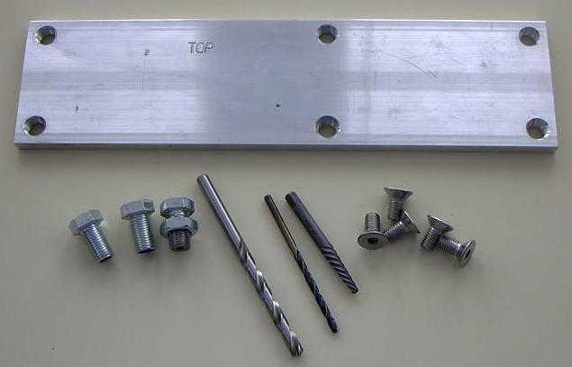

You need one of these! It's a KENT MOORE J-38782 Fiero 2.8L Exhaust Extractor Kit.
Apparently Rodney Dickman now also sells a version of it.

I am aware of the kit. However, it will be more cost effective to just get some rebuit heads.
AUG 31, 03:45 PM
| quote | Originally posted by peterh:
...it will be more cost effective to just get some rebuit heads.
I bought my KENT MOORE J-38782 kit for just over $20
