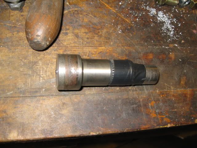

The easy way is to take a spare set of axles and cut the tripot housing off them and remove the snap ring. They slide into place and the stock axle seal keeps the water out. Ignore the tape and socket on the end... this one also has a center point to locate the axle position on a rear motor plate.

I've got a old set of axles and I did consider that. Sadly, I don't have the equipment to do that myself. I was hoping someone might have a source for the plastic ones that come in new or rebuilt transaxles.
