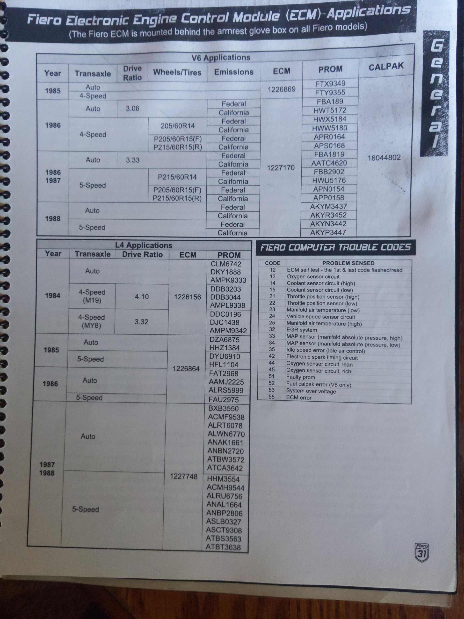

If the ECM turns out to be bad, would I be able to replace it with one from an 85 GT, as long as I change the PROM? Or would I need to get a new one?
SEP 30, 09:02 AM
The 85 GT ECU will not work, you need one from an 84.
The attached chart will help you.
