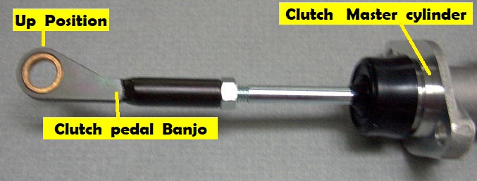

A couple of the usual questions...
Has the clutch pedal banjo been installed with the loop facing up? How far above the brake pedal does the clutch pedal sit? How far does the slave push rod move?

That's less than it should be. Not necessarily a deal killer, but your clutch pedal is probably bent at least a little.
| quote | Originally posted by Atlanta1:
No clutch banjo installed
There better be, as that's what connects the clutch pedal to the master cylinder.[This message has been edited by Patrick (edited 10-02-2022).]

I believe what Patrick is asking about ("Banjo Up") is not a musical instrument but the Master Cylinder connecting rod to the clutch pedal.

update looks like my clutch master banjo is downward
