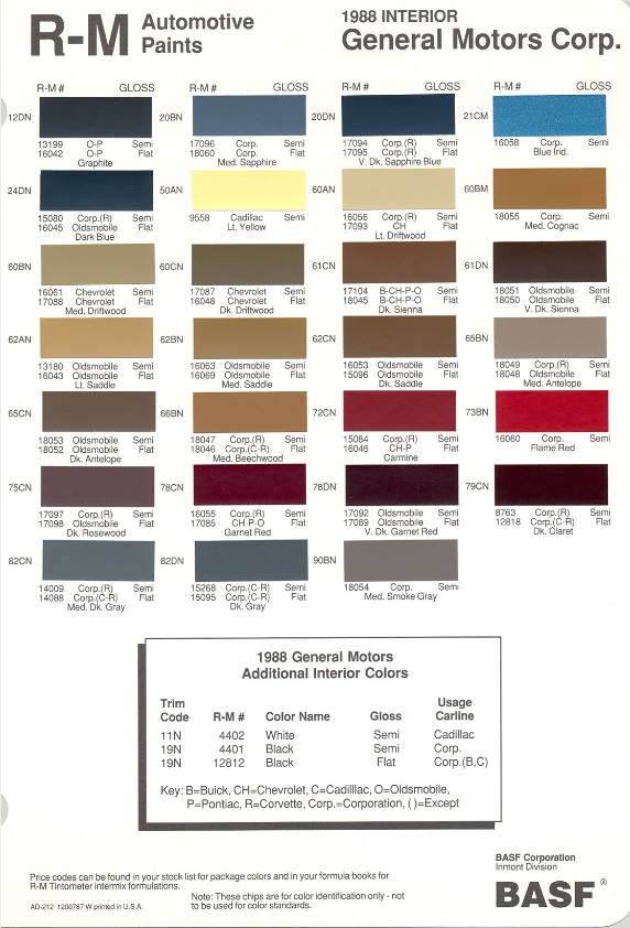

I had to paint a a-pillar trim.
I found a sheet that had the paint codes for interior colors and had a paint supply store mix up the color. Makes sure you properly clean the plastic and use a plastic primer on it first.
The color matched pretty good, but then my interior isn't faded too much as the car has been mostly covered/inside when not in use.

I believe that Sherwin Williams had a Beechwood paint in a spray can a few years back. I used some to paint the plastic seat belt cover mechanisms. If anyone is interested I can likely dig up the SW paint code number and/or supply a few photos of a finished product.

thanks guys- Nelson, would be great if you can find it, as they have a store near me.
