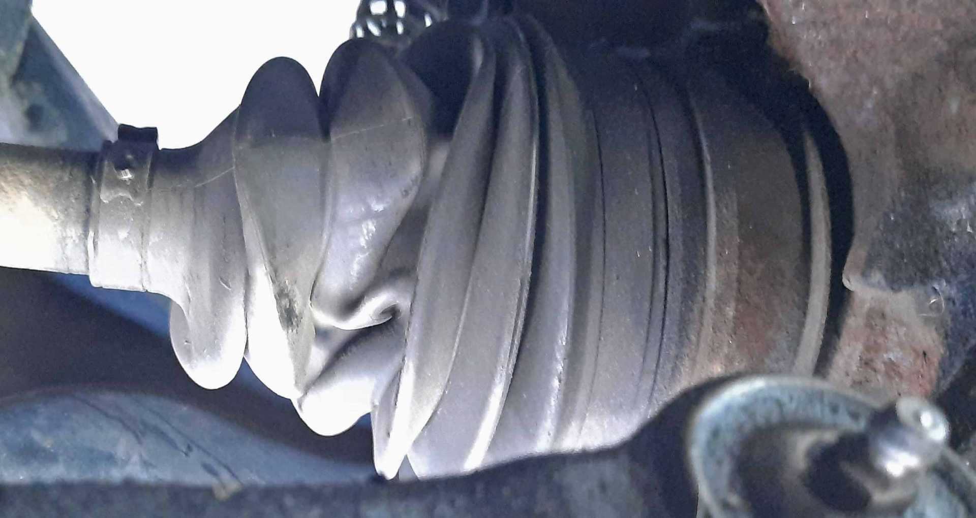

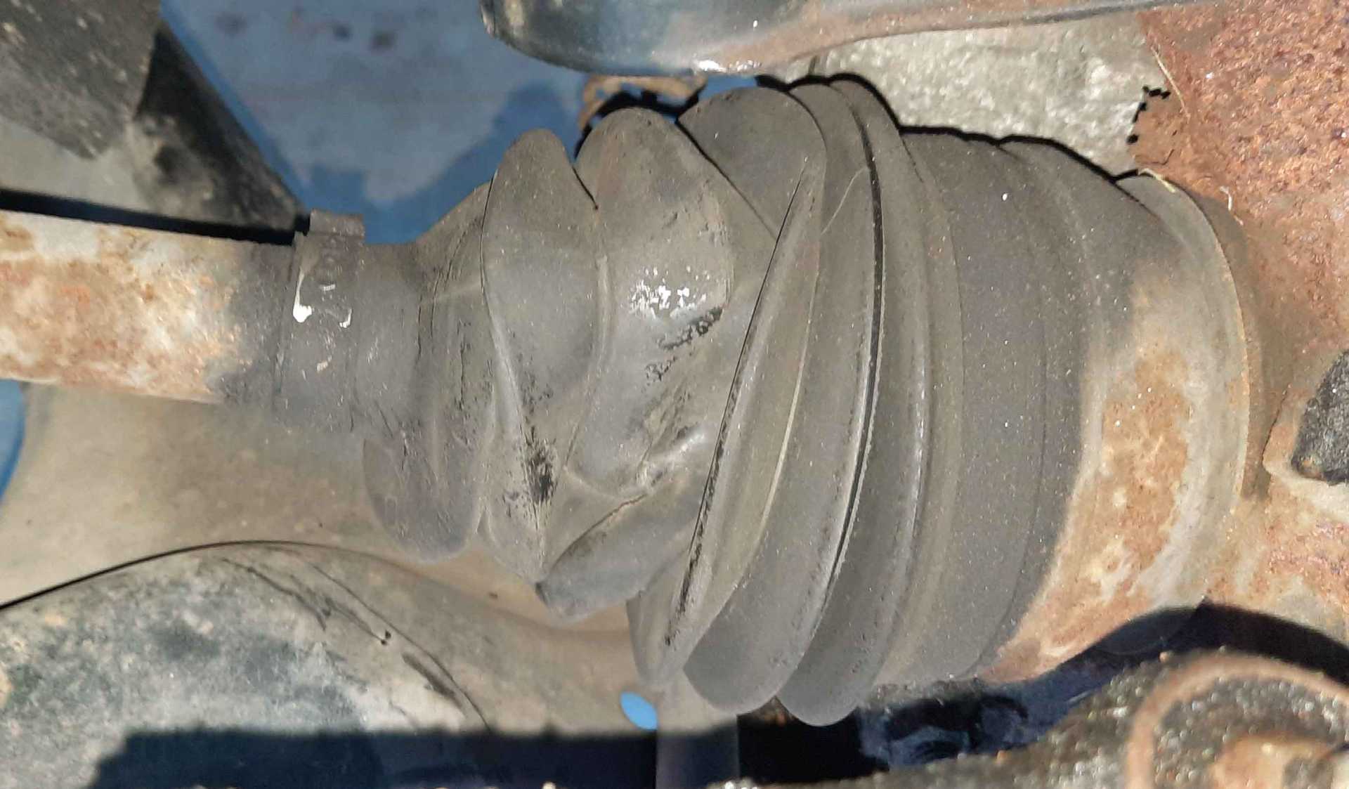

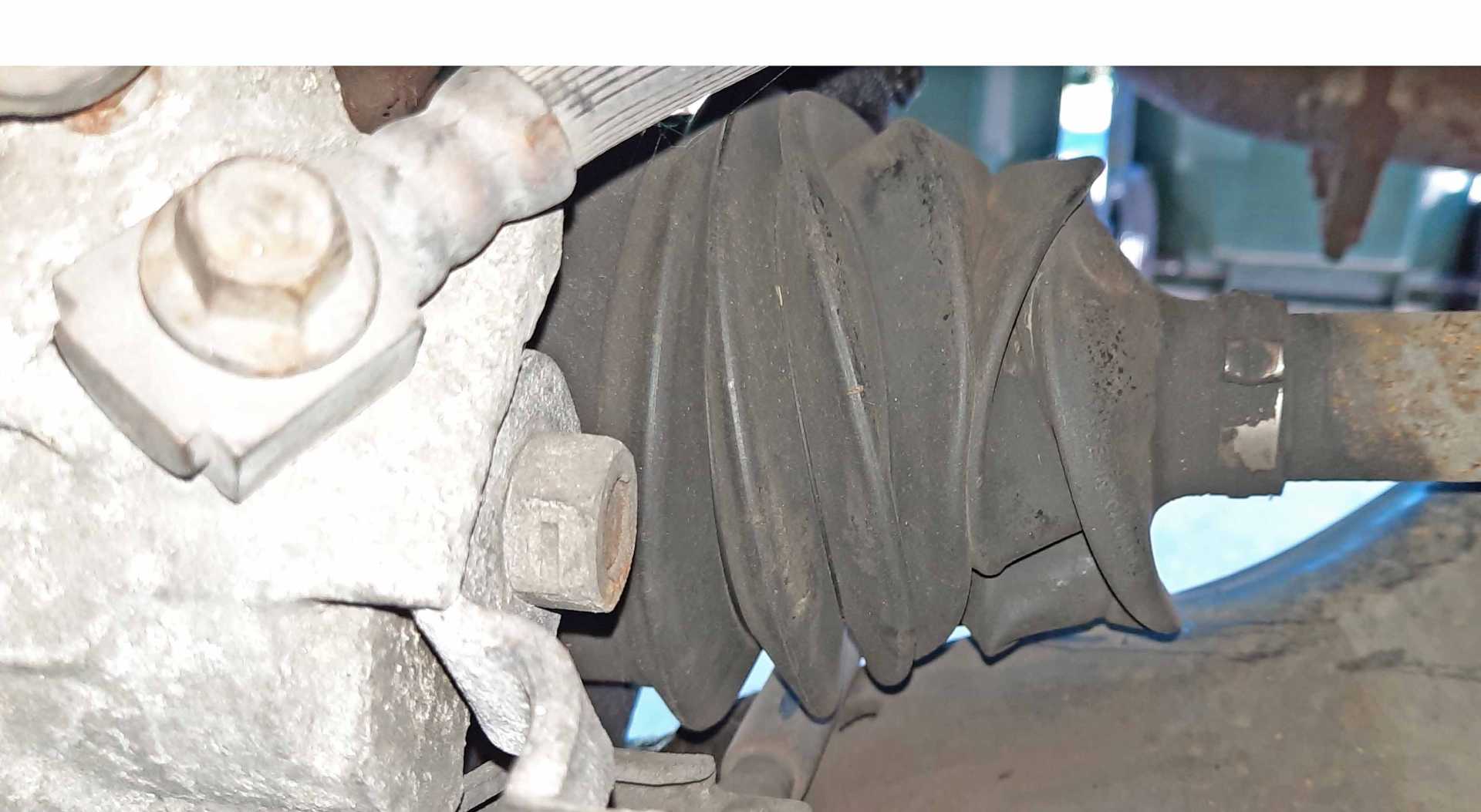

Thanks for your knowledge base. I found that the bellows on the right side axle shaft is very distorted/twisted in shape and could create a vibration at various rotational speed of the axle shaft as it binds in rotation against itself. See atttached pics. It's defective regardless and needs to be replaced. Perhaps the easiest is to simply replace with a new half shaft. Rock Auto has them for $65 shipped to my door. The distorted rubber bellows explains the creaking as the car coasts to a stand still and varies with decay in rotational speed. And perhaps at 20 MPH it vibrates enough to create what might be similar to a screwdriver left inside the door by accident or a body panel vibrating. In either case, the shaft has to be replaced and fingers crossed that it's the culprit. I did a test drive with a microphone in the car and again in the trunk space. Trouble is, I don't have an axle shaft puller. Maybe the Zone rents them out. Zone wants $100 for the shaft.

Shazamm, this it is. Maybe it's only one picture at a time. Here's another from the front of assembly.

Has anyone experienced this distortion of a CV Boot like this one in the past? What might cause this to happen?
