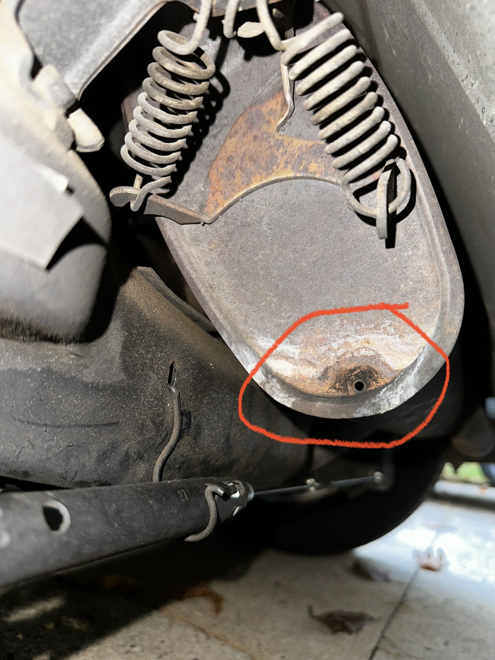

I think we might have an exhaust leak on our 87 GT. Doing some investigating we saw this hole in the muffler. Since it’s perfectly round I thought this might just be how it was made. Do I need to start looking for a muffler replacement?
IMSA GT
NOV 04, 06:13 PM
That hole is normal. It allows excess water to drain out of the muffler.
Why do you think you have an exhaust leak? Is the exhaust a different tone?[This message has been edited by IMSA GT (edited 11-04-2022).]

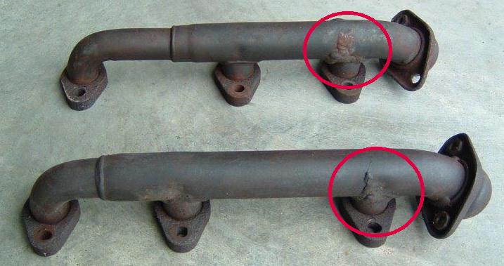

Listen around the exhaust headers. It is common for the gaskets to fail as well as the stock headers to crack and leak. They will usually develop cracks around the factory welds where they bolt to the heads.
This is a set that someone had for sale a while back. You can clearly see the repair welds on both.
