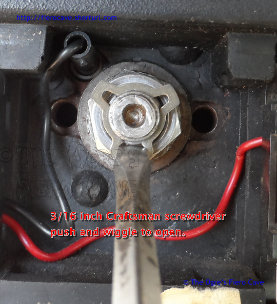

You need to save the nut and clip holding S-wheel on. If Clip is missing find something to replace it. Nut rarely get loose but can happen and clip is "Safety Wire" to keep the nut and S-wheel on the shaft. Missing clip? Many fools remove the clip or car doesn't have from the factory for whatever reason.
Need S-wheel puller and SAE Bolts. Some things are Not Metric and puller bolts is one.
