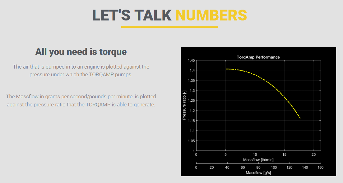

From their website:
This is way undersized for any kind of car.
You might use this to give a low-end kick to a snowmobile or motorcycle engine.[This message has been edited by pmbrunelle (edited 12-27-2022).]

| quote | Originally posted by pmbrunelle:
From their website:
This is what I have always seen with all electric SC/Turbo gimmick. The units in no way can provide enough pressure to keep up with standard demands let alone create any sort of psi for boost.
Edit: Pretty sure the math works out to 334CFM output. a 2.8 standard probably draws something like 200cfm naturally. so you would be getting 134cfm of additional force of air for the 8 or 10 seconds of boost you get out of that system...[This message has been edited by skywurz (edited 12-27-2022).]

A 2.8L at 4000 rpm with a volumetric efficiency of 75% eats 10.8 lbs/min of air at 100 kPa and 60 'F. That falls in the middle of the curve.
Because the compressor curve falls off at high flow rates (high RPM) the effect on peak HP isn't like a turbo where you get high rpm HP. The effect is more like variable valve timing where you get low and mid-range power. We have a 2017 Honda Accord with a 4 cylinder 2.4L w/ VVT and direct injection. Amazing engine - I don't know why anyone would buy the V-6 Accord.
------------------ formerly known as sanderson 1984 Quad 4 1886 SE 2.8L 1988 4.9L Cadillac 1988 3800 Supercharged[This message has been edited by sanderson231 (edited 12-27-2022).]

the other question is how much flow are you getting through that when its not boosting. Does it become an obstruction?

| quote | Originally posted by skywurz:
Did you divide the RPMs by 2?

173ci 6000RPM 70%VE = 200ish
