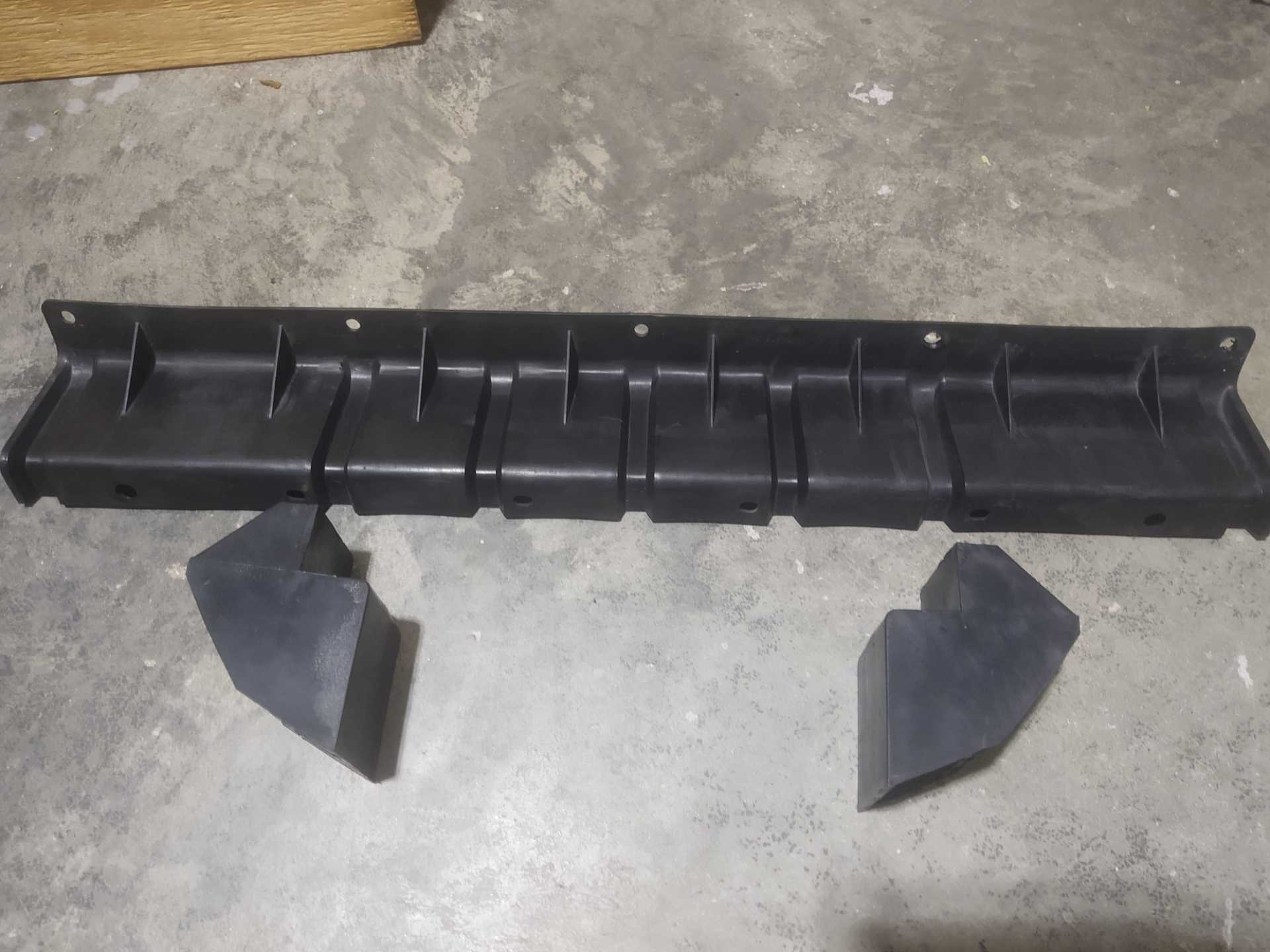

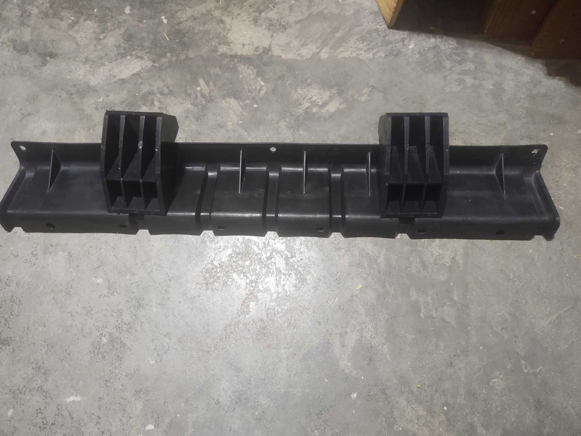

I made the classic novice mistake of not taking pictures of things while deconstructing the rear bumper and forgot where this goes exactly. I've watched tons of videos of the rear bumper but I don't see it anywhere so I am here once again asking for yalls assistance! I have an 86 2.8L notchback. I hope this helps. Let me know if you need more/better pictures.

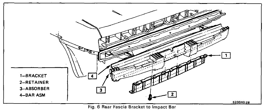

I know zero about notchbacks but according to the service manual, it goes here:
