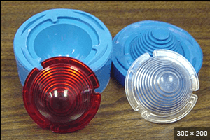

Not that I'm aware of. They made clear front turn signals but no side marker lights. The only way you would be able to do this is take a stock marker, remove the backing, make a silicone mold, and pour clear lenses with Alumilite so you retain the diffusing ribs on the rear of the lens. Similar to the lens below.
In the end you would have an entire side marker with molding that was clear. You would then glue the backing plate to the new piece, mask the lens portion, and spray the rest of the piece black.

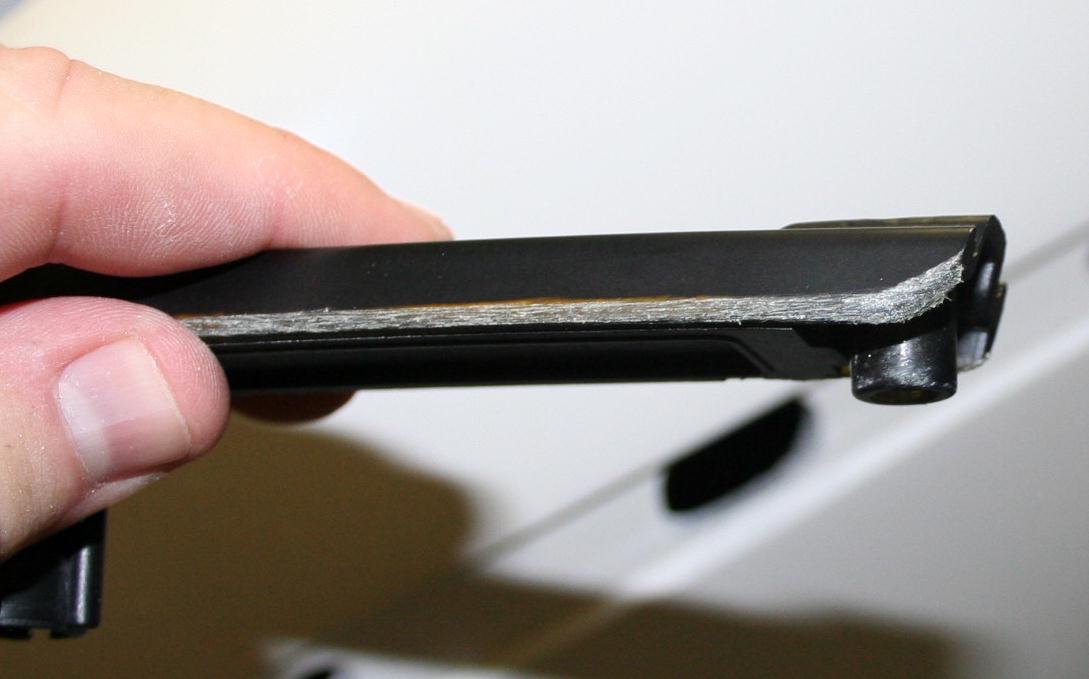

To give you an idea what I'm saying, here is a picture of new markers I bought from the Fiero Store. I had to grind an edge to fit a fiberglass body panel. You can see the amber color where I ground the plastic so that means the entire piece is actually amber with black paint covering most of the piece.
