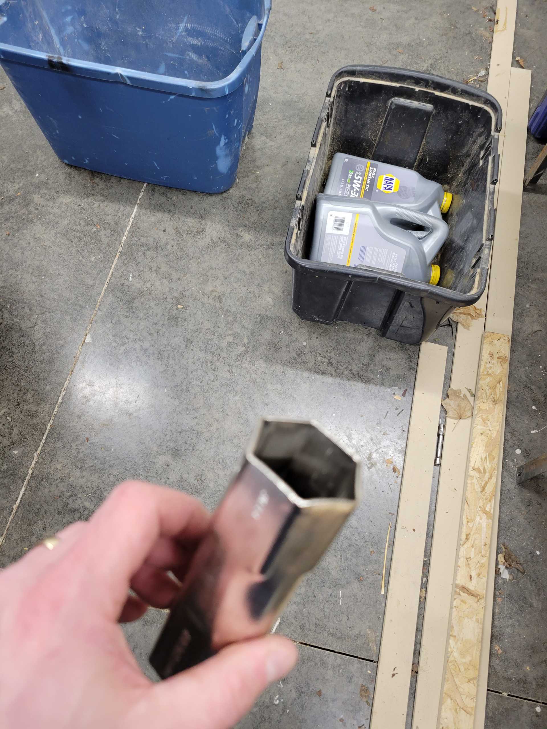

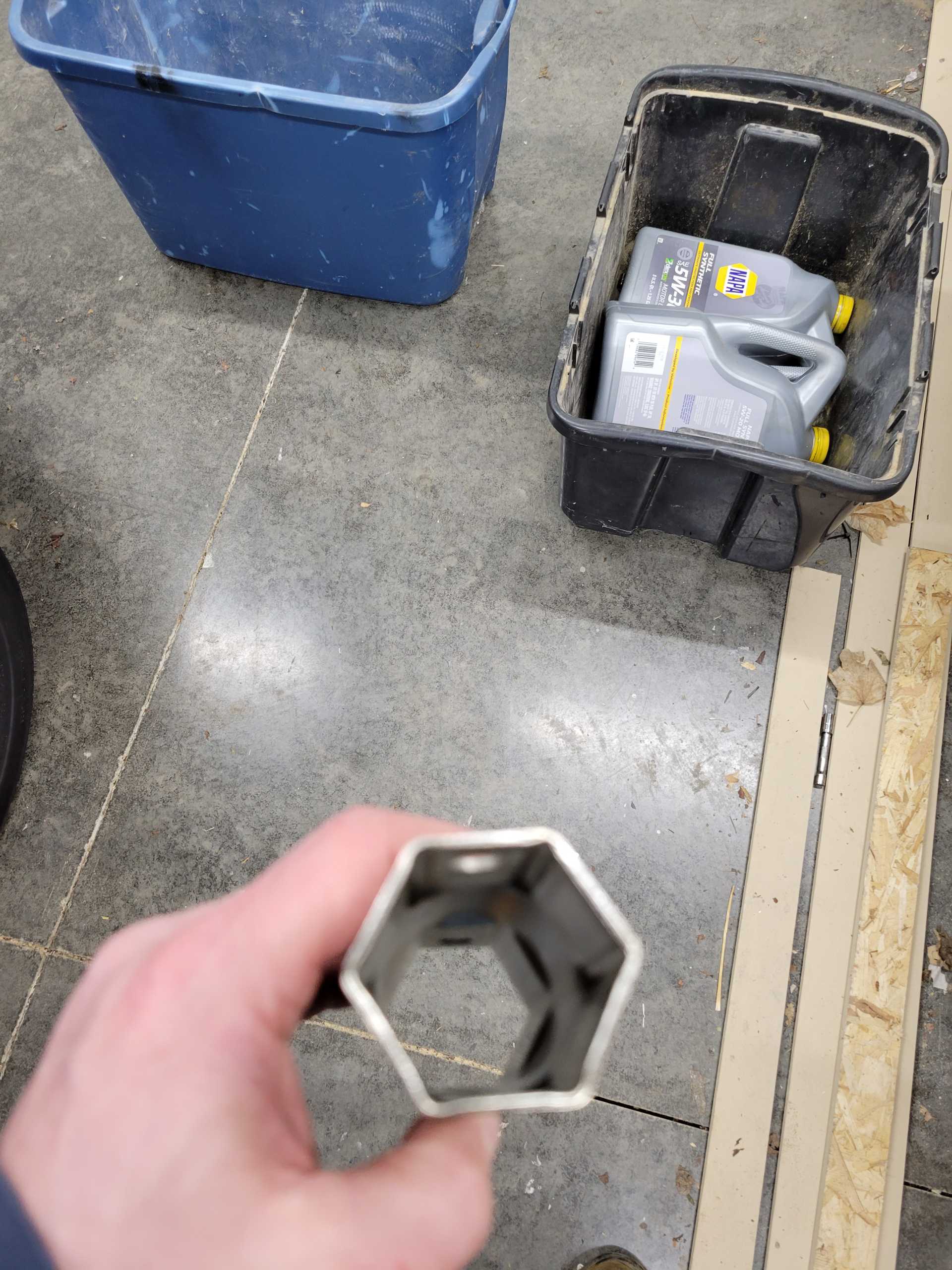

I am sure this has been thought of... but I discovered the perfect tool. 1 1/4 shower valve tool. Very thin wall and slips in the tight spot.
Spadesluck FEB 18, 05:55 PM
Haha, I have one of those and never thought to use it. I just put a big adjustable on there to take mine off before.
