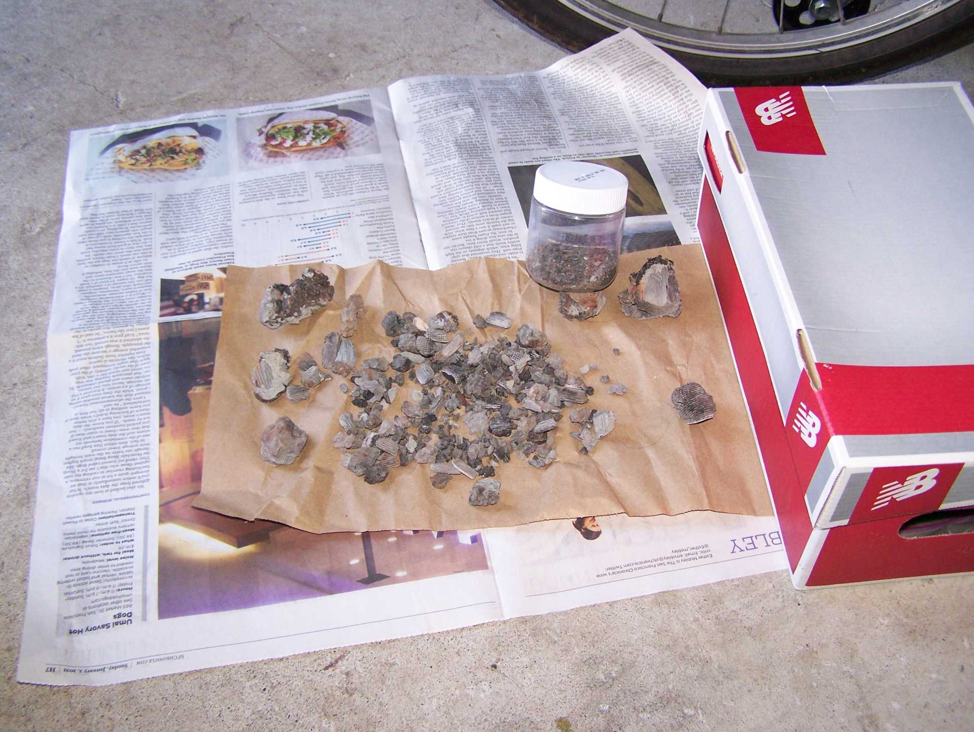

I want to say; My 85 SE V6 sounded horrible after the Cat disintegrated...The exhaust was clogged with pieces of that cat (But no dogs!)
I took the exhaust off and, looking at a diagram of the muffler, started shaking the exhaust and got most of the crap out and it sounded much better.
Later, it started making more noise but only when lugging the engine (third or fourth at 1500 rpm (Floored)...Took it off and shook it out again, and then it sounded better again.
If you have "Cat crap" in your exhaust, you can tell by taking it off and shaking it; It will rattle! (Added note- the performance of the car did not suffer (Yes- I am amazed at that)

quote | Originally posted by cvxjet:
It literally looks like you're digging through fossils!
