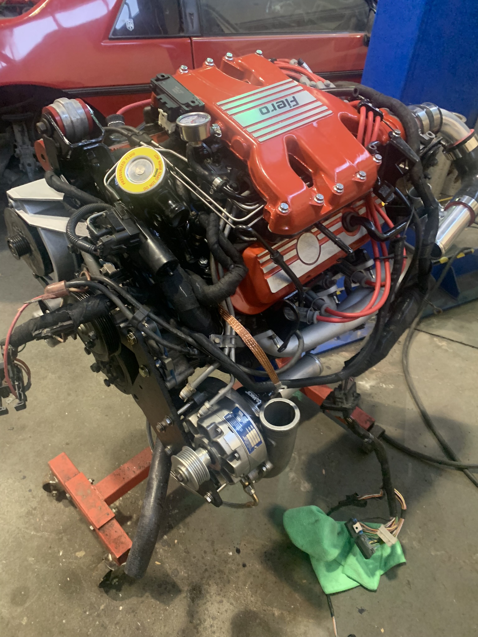

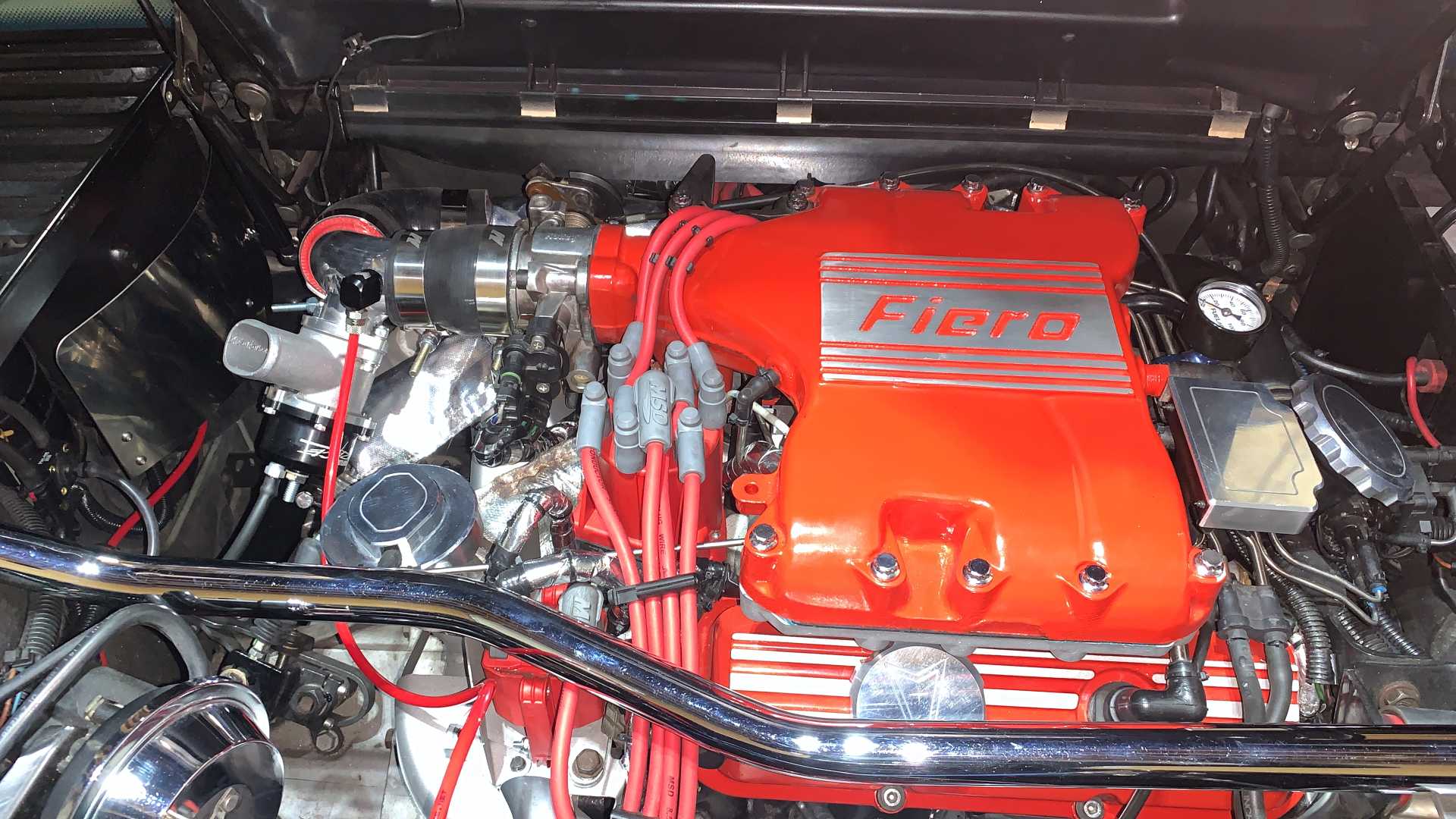

I would go one step further. 3.4 F body with a supercharger. If your formula doesn’t have AC then this is a perfect option. And I believe you’re a mechanic so cost won’t be much if you’re doing it yourself. Sc will cost the most but you can find a used one. I have a spare custom bracket and can help you with what you need for the build. You’re in Niagara? Message me. Also look at my build for m the construction zone Mister ttop build. This set up is with a v5 Vortec SC. I originally started with a V1 set up on my 87 5speed then upgraded to a V5 and custom crank pulley. This pic is of my set up for My automatic ttop. Haven’t dyno the 5 speed yet but I can tell you from feel is above 250 hp. Its totall rips around. I burry the needle in 4th on the highway. Now the 3.4 blocks are getting harder to find especially here in Canada.
Here’s the engineering me in the 5 speed. I did the plenum mod similar to the ppg pace cars what had a 3.1 turbo set up. It feels and sounds amazing but not a cheap swap. If you’re handy and can do it yourself it will still cost you around 5-6k Canadian in parts and tune. I use Ryan from sinister so if you do the same set up he already has some files to get you started.
