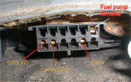

  Do the test this way. Jump terminal "G" at the ALDL connector with 12v from the cigarette lighter to run the fuel pump and see what happens. I believe this bypasses the relay.
  What is the reading while the pump is running... and how quickly does it drop when the power is disconnected?[This message has been edited by Patrick (edited 06-15-2023).]
