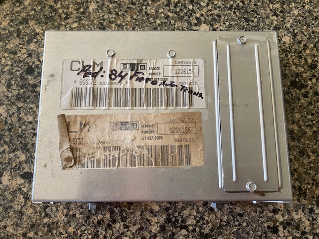

Hi, is it an automatic? I have an 84 Automatic complete ECM available if you want it.
Note: I also owe someone else an 84 manual (which is in storage). But like with the other individual, if you want it, I'm happy to give it to you for free... I don't want anything for it. But I highly value my time. So... if you can mail me a shipping label w/ postage for a thin medium-sized Priority U.S. Mail box, I will send it out to you for free. I don't know what shipping will be from the U.S. to Canada, but if you want to mail me a shipping label, the ECM is yours.
This is it. I cannot confirm if it's working, but these generally don't go bad, it's usually everything else. Back in the day when I'd see a Fiero in the junkyard, these were $10 a piece, so I used to just snatch them up if the car was likely going to get crushed that day. This one might have come as a spare with another car I purchased too. Let me know... I'll PM you my address.
The benefit to me is that these don't go to waste and it helps keep a Fiero on the road.

EPROM is not soldered in - it is in a socket (well actually it is in a carrier which is then inserted into the socket - no soldering required).
That being said you need the equipment to erase and reprogram it and if you do not have this equipment it is easier to just find another ECM (lots of 84 out there).
Just make sure you get one that matches your car (84 and automatic or standard transmission) as the code is different between the different transmissions.

Thanks for your kind offer but my 1984 fiero is a standard
