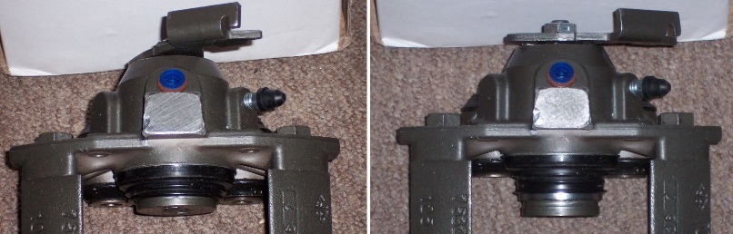

I'm an original '88 GT owner and my passengers’ rear inner brake pad was thinner than the outer pad so I knew the caliper needed ‘help'. I thought my best option was to send mine to ‘Calipers Online’ to get them rebuild and I paid $25 extra per caliper for their ‘R&R Service’ to rebuild my original calipers.
Now, my rear calipers are NOT working the same, ugh!
When Moving the Parking Brake Lever Back and Forth on the Bench
On the drivers’ rear caliper: the piston will move out to the rotor (park on) and will move back into the caliper (park off) constantly at the SAME TRAVEL. (I believe this is correct)
On the passengers’ rear caliper: the piston WON'T go back into the caliper (only out/forward to the rotor) and will push the piston out of the seal. (See Photo Below)
‘Calipers Online’ Response: “There is nothing wrong with it. If you are working it in your hand it will look like there is a problem, but on the car it will work. You will have to turn the piston to get it to go back in.”
FYI: ‘Calipers Online’ is only the ‘middleman’ and subcontracts the work.
To me, this means it will not self-adjust the internal parking mechanism and the ball bearings and/or thrust washers aren't working correctly.
‘88 Rear Brake Caliper Piston Actuator
I know that new ‘88 rear piston assemblies are no longer available. The only option is to pry the ‘cover’ of the back; remove the ‘guts’; inspect the thrust washers and ball bearings, then replace the inner seal.
Mark (Calipers Online) wants to trade it for another caliper, and I believe their rebuilder didn’t open my original piston assemblies.
To me, I feel that I’m wasting my time; cut my losses and send them to ‘Phoenix Caliper’ in Illinois. Thanasi (‘Phoenix Caliper’) says their cost to fix the issue is $125 plus shipping from California and back.
SO, does anyone have a ‘better’ shop to send them or ‘Phoenix Caliper’ is the best option?

No the piston shouldn't really return in the same amount that moving the lever will jack it out. That's not how the piston Ebrake mechanism works.
I don't know why one would do that to an unloaded caliper, at least mount a rotor in a vice or so and install the pads into the caliper THEN test it before mounting on the car.
Sitting there jacking the piston out with nothing to counteract the action is just creating a problem that doesn't exist.[This message has been edited by jelly2m8 (edited 07-15-2023).]

So, you believe moving the parking brake lever back and forth has no relation on the bench?
I'll follow your suggestion:
*I'll put the piston back into the caliper *Mount a rotor in a vice *Mount the loaded caliper on the rotor *Test the parking lever to see if it will release the inner pad or not....

Obviously, I was ignorant on my first encounter with the rear brake caliper and piston actuator....
Thank-you very much jelly2m8 by kicking me in the head and your 'suggestion':
*Using the J-36621 piston rotator tool, and bottoming the piston assembly in the caliper bore, and then rotating it more to align the piston holes, I understand that the outer piston and the inner piston are rotating independently.
*With a rotor in a vice and mounting the loaded caliper on the rotor, YES, the parking lever will self-adjust the internal parking mechanism will release the inner pad!
The Ogre's Fiero Cave on the Rear Caliper Construction page helped allot too....
Yes, I was just creating a problem that doesn't exist, thank-you again!

| quote | Originally posted by Vintage-Nut:
Passenger side is working correctly, driver's side is not.
The act off moving the parking brake lever "self adjusts" the piston length for the correct gap when pads and rotors are installed. Since the driver's keeps retracting without any of the other hardware installed, the adjustment mechanical is not working as it should.
JUL 17, 04:22 PM
If the pads are thinner on one side than the other, it's not a caliper piston problem.
All you needed to do was remove the slide pins and regrease them.
The slide pins were stuck, not allowing the caliper to recenter......
