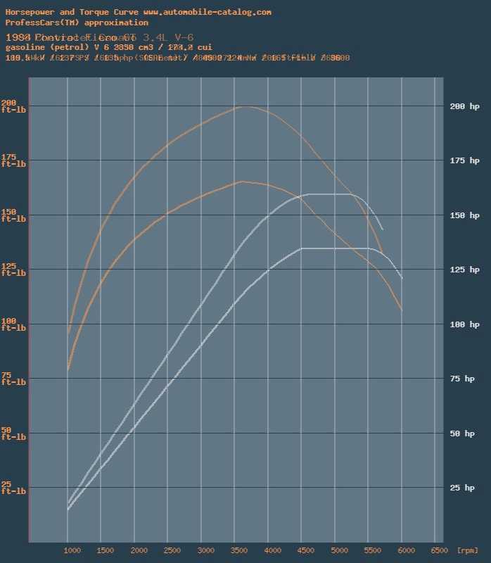

A_Lonely_Potato
JUL 28, 08:34 PM
for what its worth, heres the power curves of a 3.4 camaro and a fiero GT overlayed. i know there are different losses given the transmission and axle setups, but its ballpark.
(the 2 upper lines are the 3.4...obviously)
