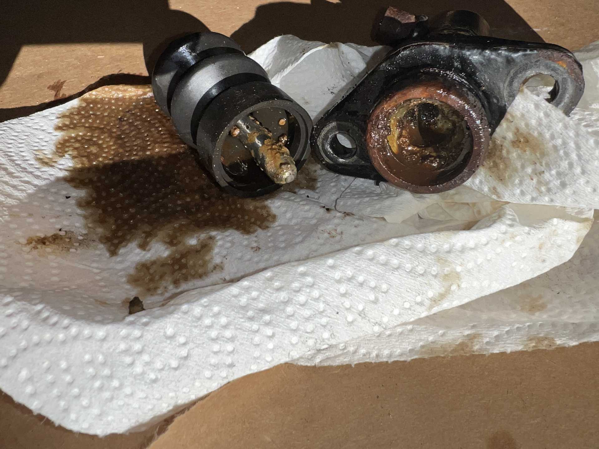

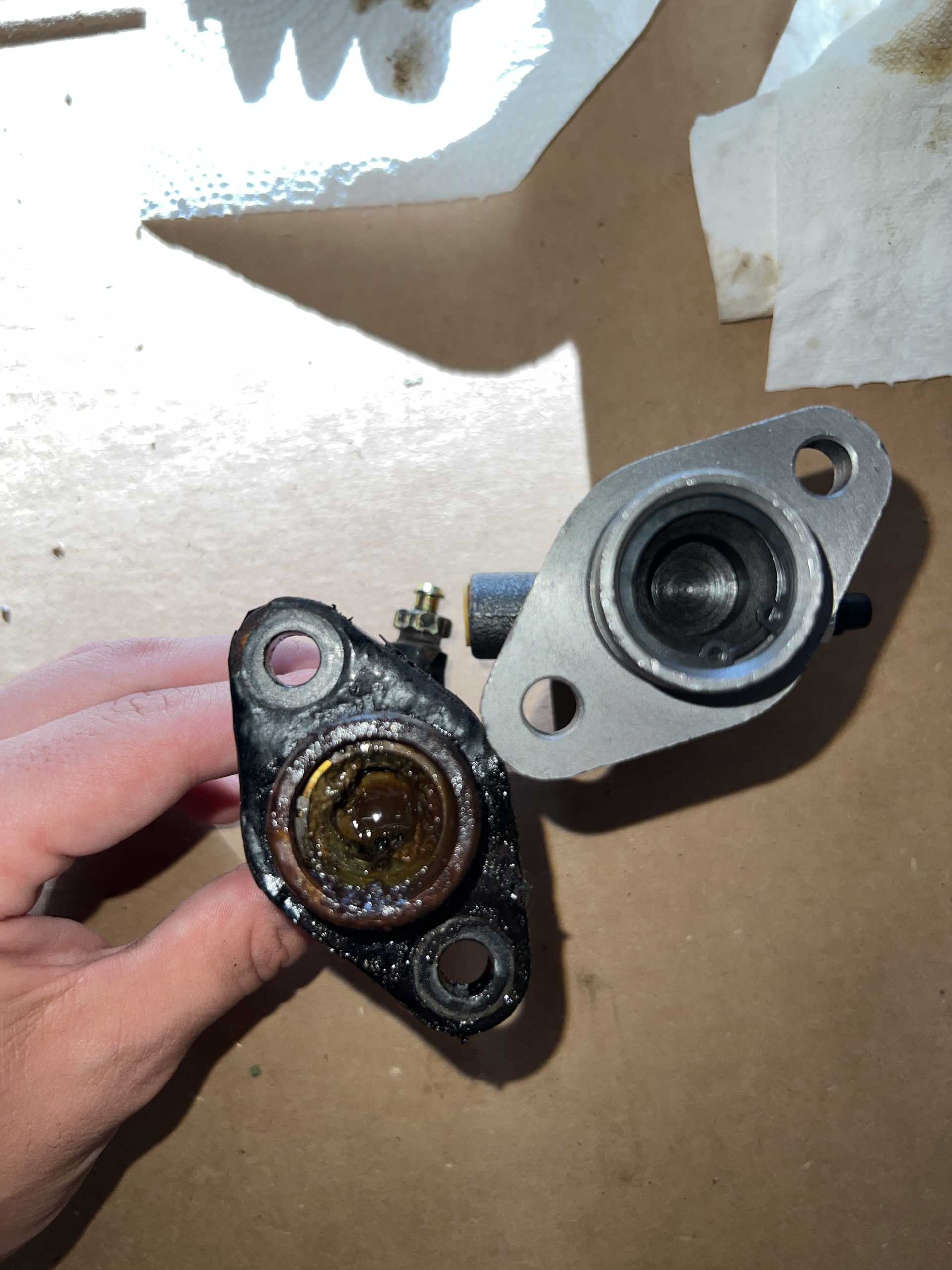

. As a fun side note, when I did mine recently, I was hoping I could maybe clean mine out and salvage the old one for future use...I quickly thought otherwise...
Old Slave and Rod
Old and New Side-by-side
