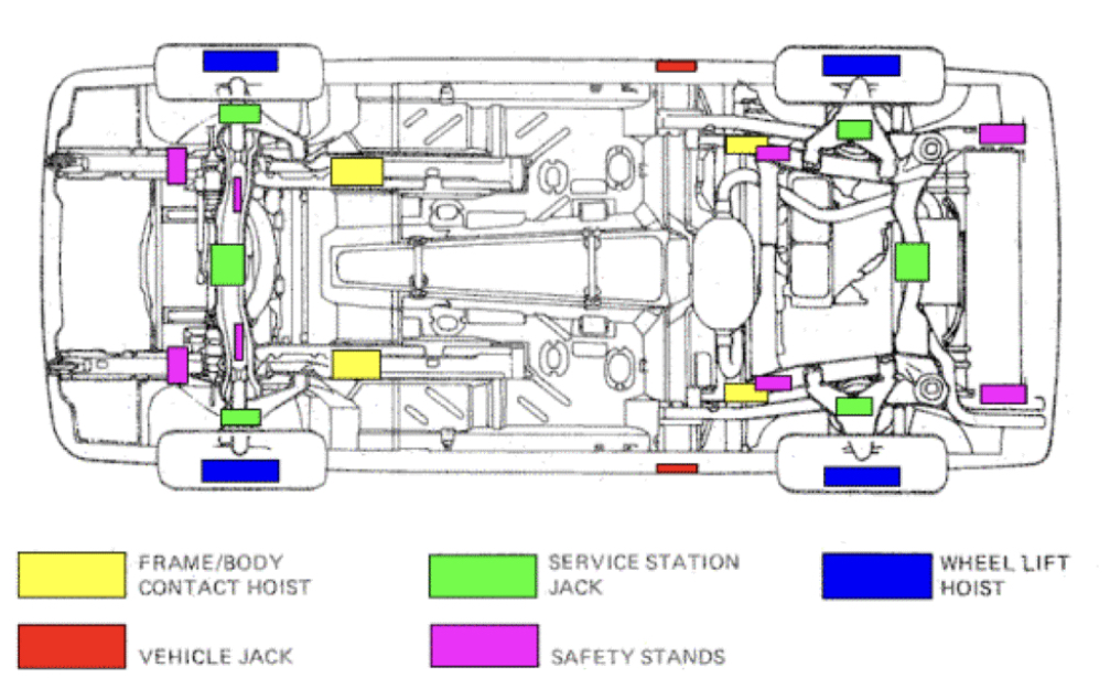

              AUG 08,  08:57 PM
             Where do you plan to locate the jack stands?
              sdgdf
              AUG 08,  09:35 PM
 | quote |  Originally posted by Patrick:
  Where do you plan to locate the jack stands? |
  Those pink jacking points ahead of the rear suspension. That’s where I’ve been setting the stands working on the rear.

              AUG 08,  11:05 PM
 | quote |  Originally posted by sdgdf:
  So you wish to raise the car with the suspension fully dropped, and have the engine driving the rear wheels while in this position? I don't know for sure, but it seems to me that this would put undue stress on the CV joints working at that angle. I think I'd prefer to have the weight of the car supported by blocks of wood under the rear lower control arms, thus allowing the suspension to be at regular ride height while the engine is driving the wheels. Maybe someone else could chip in here on this as well.
              AUG 08,  11:08 PM
  What? The torque will kick it off the jack stands?
  If the car is lifted by the cradle, and the suspension droops, the axles can over-extend and maybe allow the tripots to do "funny things", since they're turning at an extreme angle.  Best to support the car by the cradle, and then put a floor jack under the knuckle.
  Although spinning the wheels with the car in the air is kind of sketchy. (Yeah... I've done it. But it still is sketchy.   )[This message has been edited by Raydar (edited 08-08-2023).]
