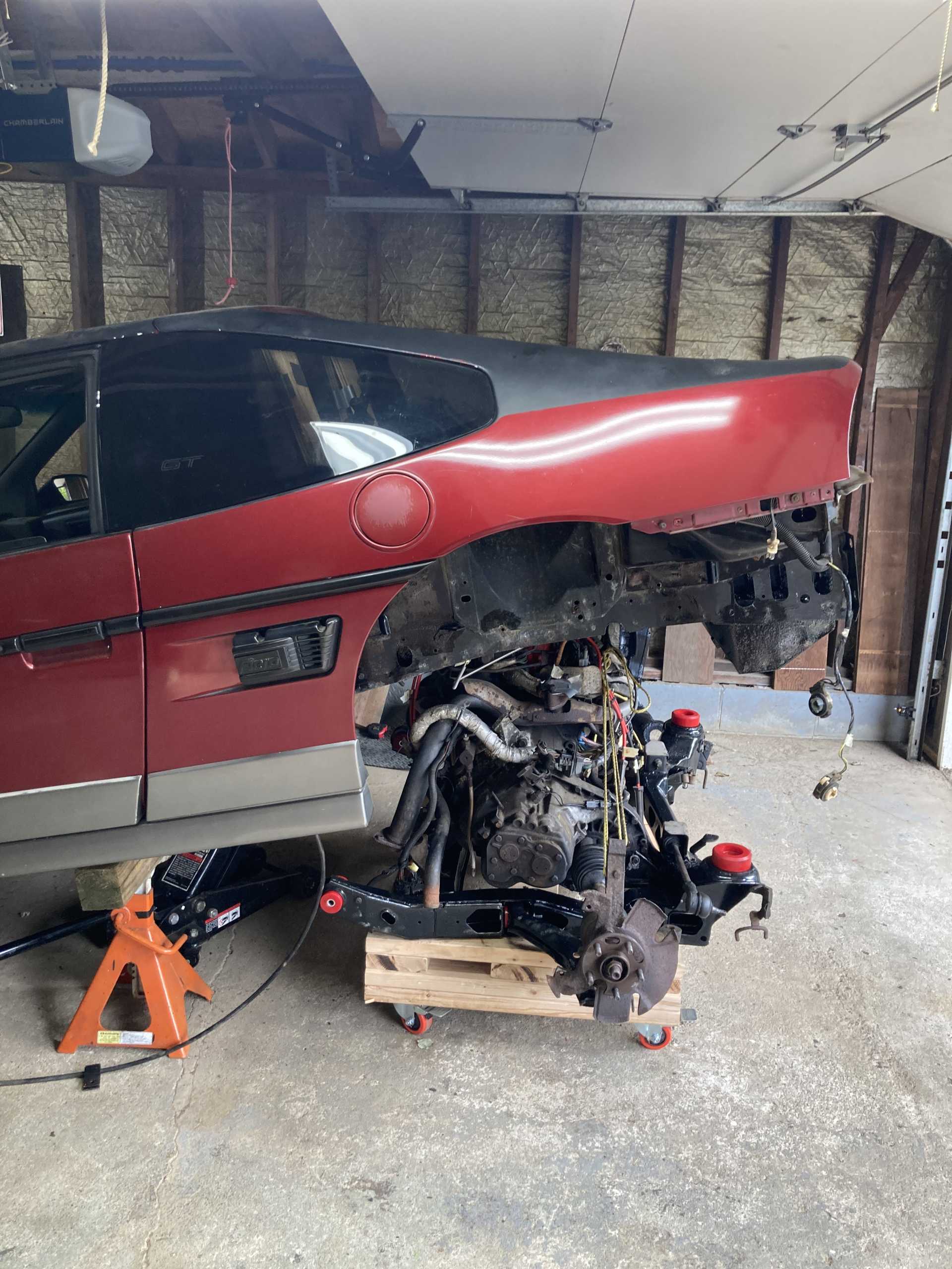

I'll post some pictures later tomorrow or Tuesday. We got the subframe out from under the car... it was a chore. The engine hoist lifting the car worked like a charm. I also totally forgot to remove stuff from the car until I remembered that maybe Raydar had told me to check... and I was like, oh crap...
Everything went smoothly except for a SINGLE.... a SINGLE subframe bolt which was rusted to the sleeve and would not budge... no matter what I did. I hit it with an impact wrench for like 20 minutes, wouldn't budge. I cut one end off, stripped the other, and eventually it broke free and I could muscle it out with a pair of vice grips and a dead-blow hammer. I was so frustrated... I went through like 4 metal-cutting saws ... all just for one bolt.
But we were able to get the car lifted and pushed it out from underneath (we had the two wheels on wheel dollies from Harbor Freight), and then put the car carefully back down on two 6-Ton floor jacks.
So now the fun begins.
I broke some stuff though... so I'm going to have to get a new rocker panel
