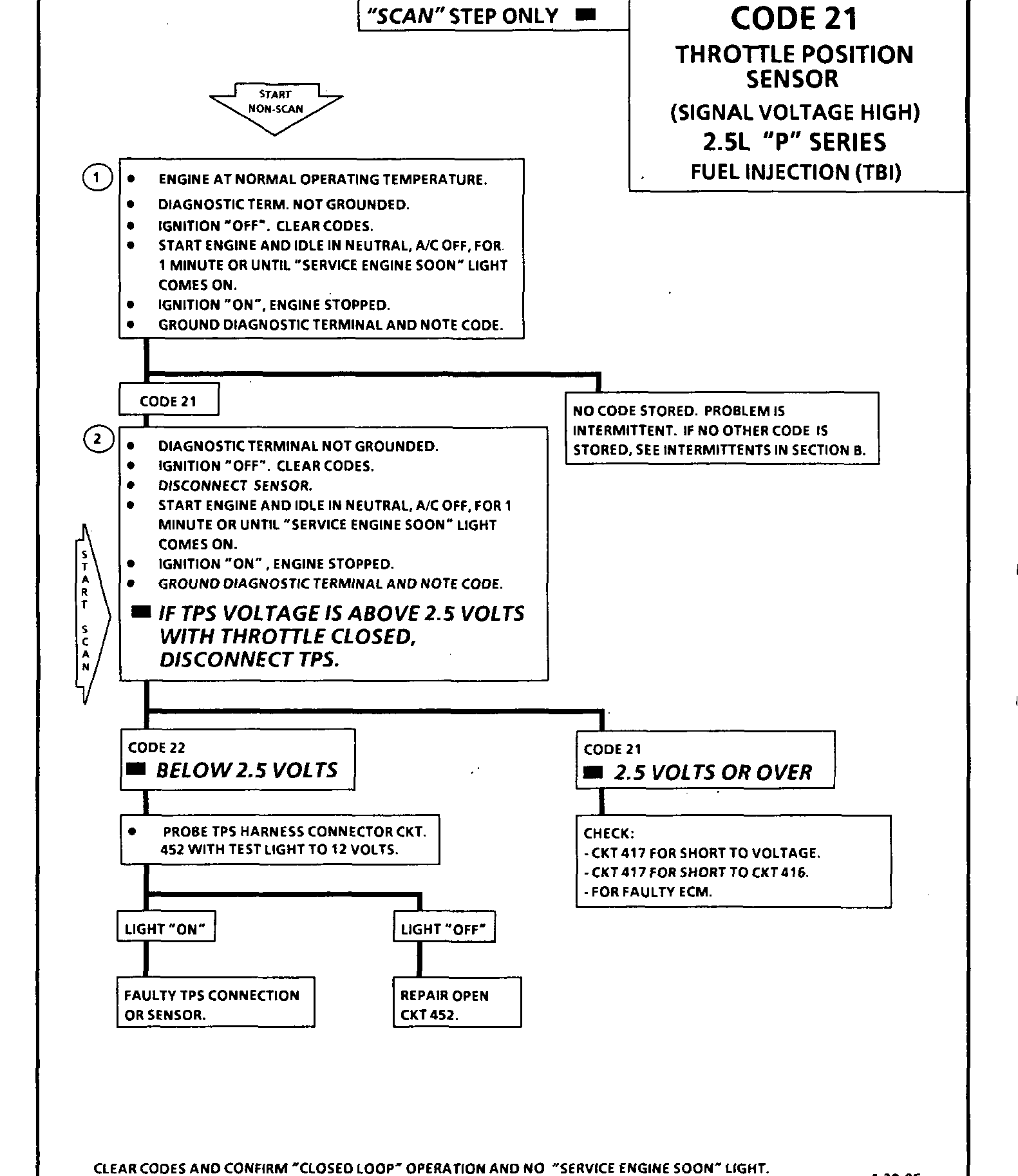

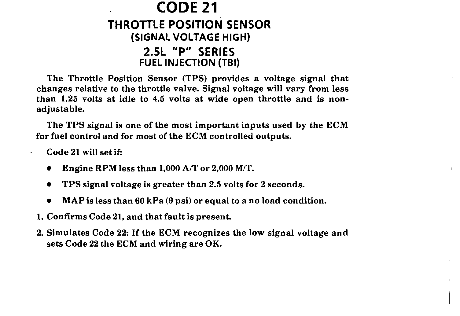

So here we go...I go out today and test my TPS. These are the readings at fully closed and open with the key on:
Top Wire (Black) - .02v full open and closed no change. This concerns me a little, isn't this my ground? Why would it have any voltage at all? Does this mean I may have a short or is that ok?
Middle Wire (Blue) - 4.78v full open, 1.18v full closed.
Bottom Wire - (Gray) - 5.03v open and closed (does not change)
I'm pretty sure those numbers indicate something is wrong..but like I said I just replaced this TPS maybe 2 months ago at the most...Did I fry it with the positive battery cable having issues? That's my best guess what happened. Let me know if you think so too.

See if the resistance of the TPS has any breaks as you slowly move the TPS arm all the way through it's sweep. That would indicate a bad TPS. I had similar issues, it turned out the wires going to the TPS had an intermittent break, splices in a new connector with a few inches of wiring, no more issues.
