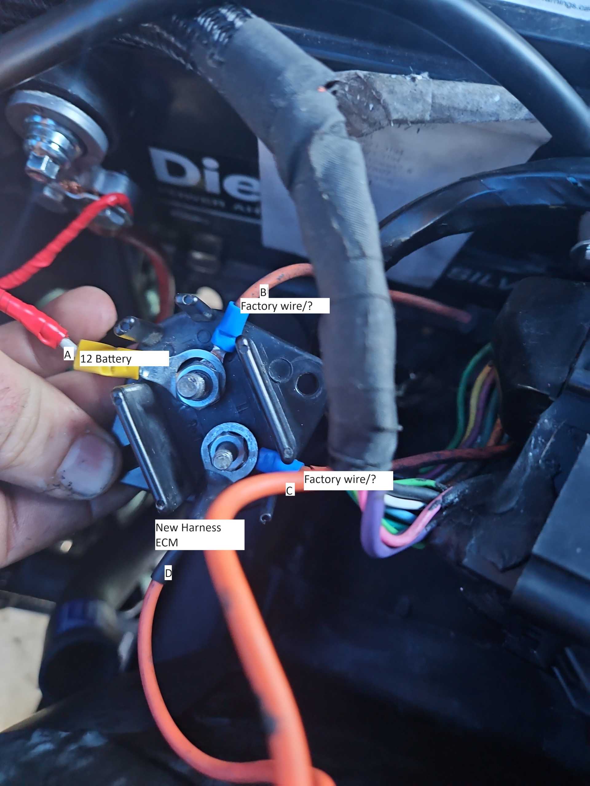

In the final stretch of my 87 Fiero's 3800 engine swap, I hit a snag. Initially, connecting the fusible link brought power to the interior, but the headlights didn't cooperate. I took the fusable link apart and re-did the connections – now, there's no power to the fuse box / interior despite having 12v on both sides of the post.
Anyone faced a similar situation during an engine swap? Power loss to the fuse box has me stumped. Checked connections, fuses, and wiring, but no luck. Any insights or suggestions would be greatly appreciated. Eager to get back on the road.
Here is the current fusable link connection is this correct?
frockfiero
OCT 04, 07:13 PM
I get 12.57v on the battery side and 11.97 on the other side. My test light flashes on the small side. bright on the battery (large) side
OCT 04, 08:04 PM
There should be a jumper bar between the two posts of the Battery Junction Terminal.....
frockfiero
OCT 05, 06:28 AM
Thank you. Do you know where I can get or what it is called, for the terminal end with two loops?
OCT 05, 07:15 AM
The alternator lead from any 85-88 Fiero has one, or the you can make one from a piece of brass or copper.
frockfiero
OCT 09, 11:12 AM
Thanks this is solved. Two issues found.
One missing the lead on the alternator wire (fixed) Bad ground on the engine. I sanded and remounted the ground then every thing worked as expected.
