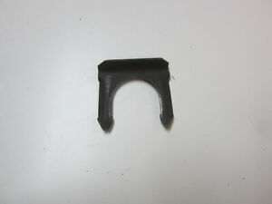

I guarantee to you that this is something easy / simple that's wrong with the car. If everything worked well before the slave replacement, then it's certainly something that got dislodged or messed up.
Question, have you driven the car OTHER than tried to reverse it?
I can't remember the shift pattern, but I had a 1985 Fiero GT 4-Speed (such an awesome car), and one day after coming back from the movies, I could no longer reverse, and I THINK... I think I also could not get into 2nd or 3rd gear. Not sure which gears it was... but one of my forward gears also didn't work.
I just kind of looked around in the engine compartment, and immediately noticed that the metal clip which held one of the shifter cables to the transmission bracket had broken. These eventually fatigue, and they just break.
Anyway, in order to get home, I think I used a bunch of zip ties and whatnot... but you can buy these replacement clips. I just tried looking for them on Rock Auto and couldn't find them. I know they aren't super-rare or anything, I'm probably just not looking in the right place.
Anyway, I GUARANTEE to you that this is the problem. So don't fret... I promise... you can fix this really easily. Just take a look at this bracket HERE...
