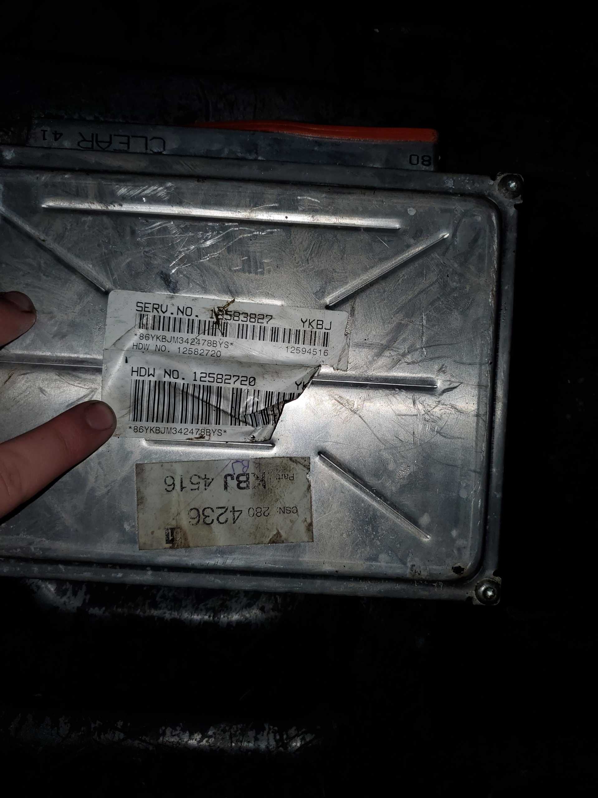

I have a 4spd 3800, I can't go WOT without it falling flat on it's face and all the timing gets taken out of it. It feels like a rev limiter and the only thing I can think to do is a CASE learn since it's a different PCM than what came with it. I've seen the post that says to jumper pin X to ground and whatever but I can't seem to make heads or tails of my harness connector + the guy who did the harness pulled the pins that weren't being used out so I don't have any colors to go off of. Does anyone have pictures or a guide that explains it like I'm 3 years old? I also have an O2 sensor code for the one coming out of the manifold but even after replacing it and clearing the code, it still persists. Wiring checks out so all I've got left to go off is maybe my PCM is shot.

The PCM should have the same part number, as all 3800 PCM's are not pinned the same.
I doubt the PCM is junk, they are very reliable.
What PCM # are you using? What year engine?

Its out of a 2004 monte carlo. I think Danny is going to send me a new one and see if it's a PCM issue. But it's still not out of the question that it could just need a case learn
