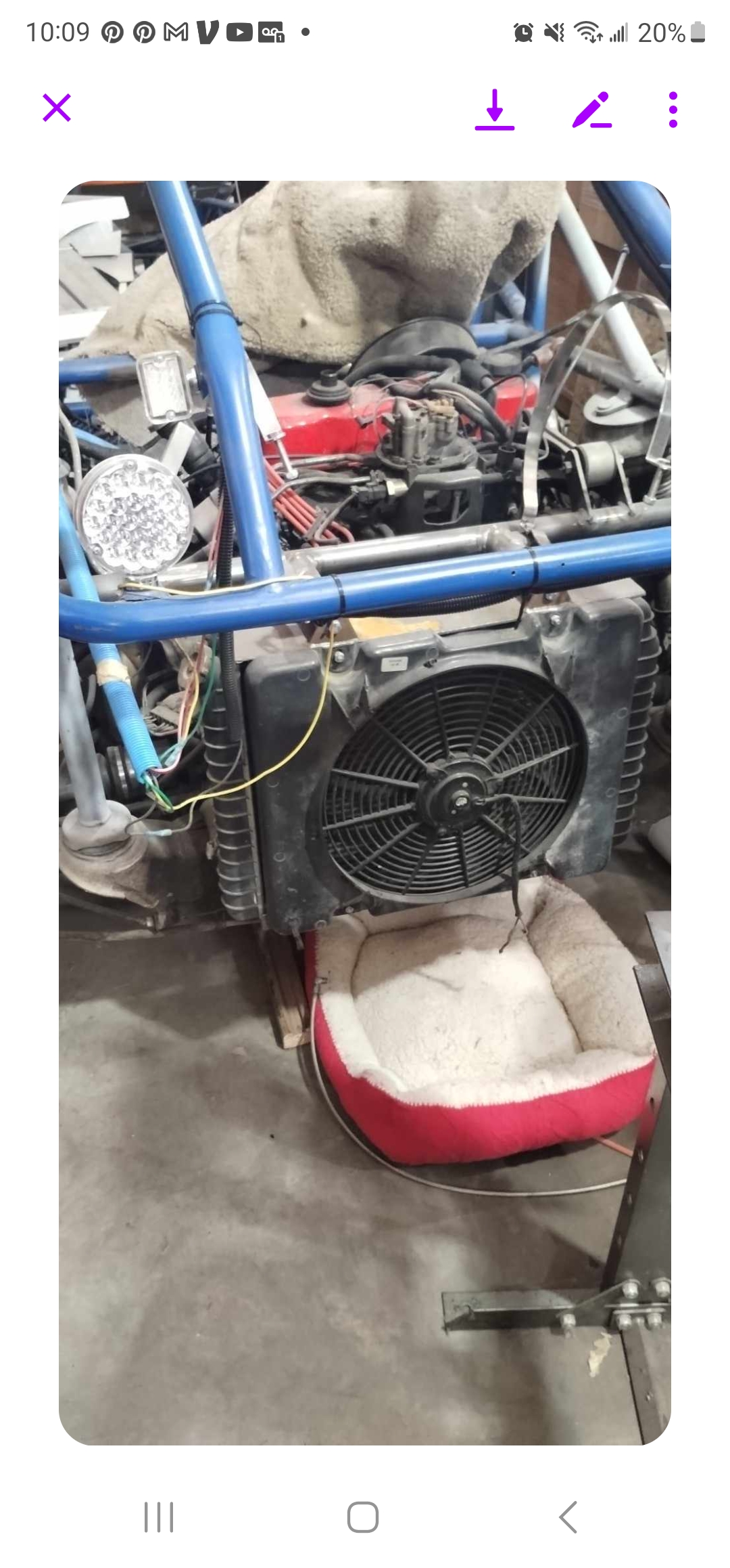

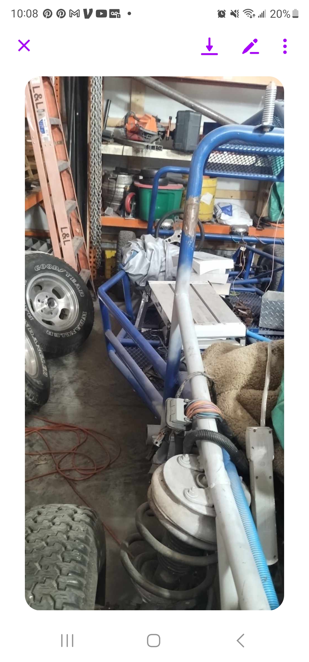

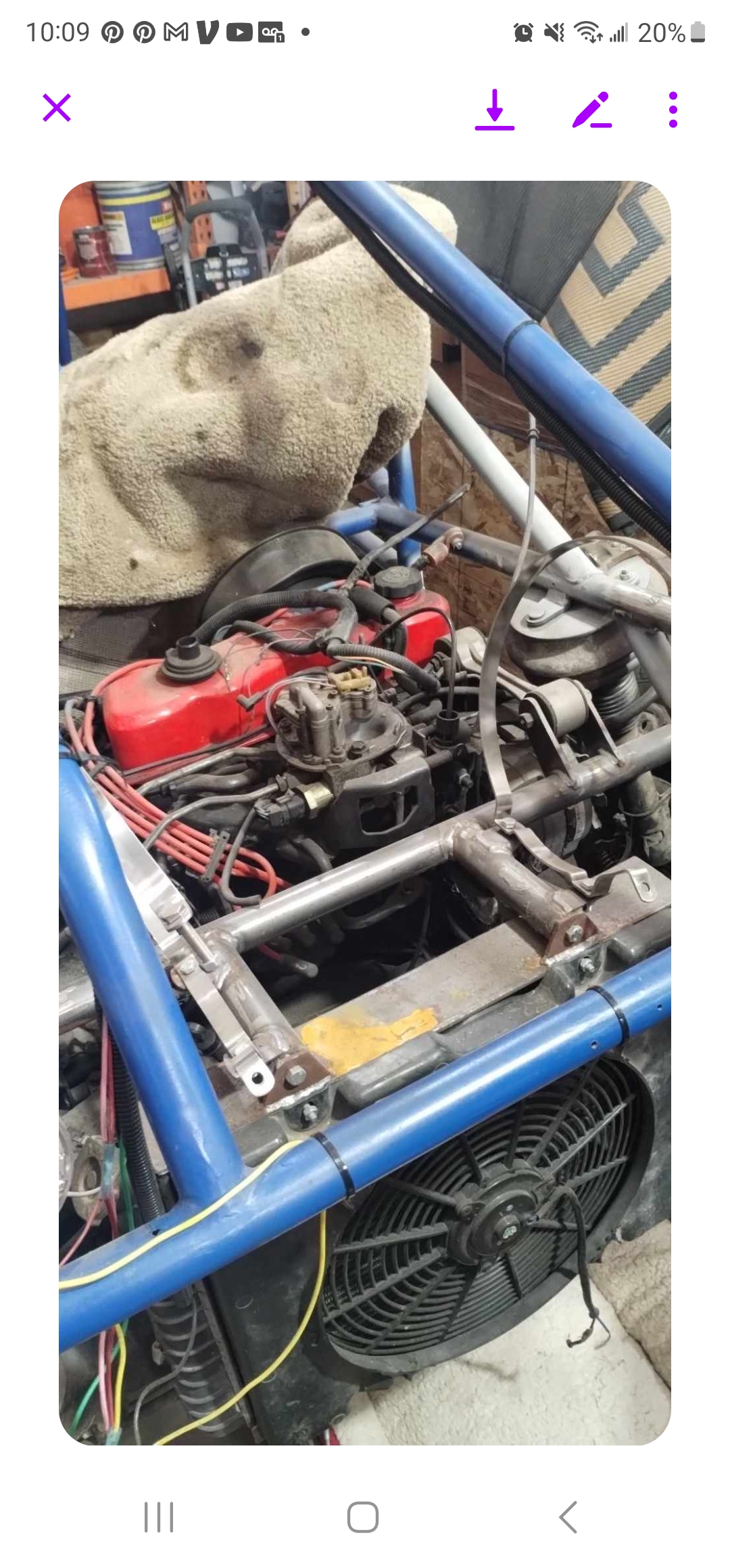

I am a long time dune buggy owner and builder. I recently acquired a sandrail with a 1984 Fiero rear cradle installed with a 2.5 Iron Duke and automatic transmission. I had my knee replaced and am looking forward to an automatic buggy. It is an incomplete project and I am in need of a little help. Does anyone know of anybody that cuts down (deletes not needed wires) wiring harnesses and flashes the cpu? Thanks for any help. [img]https://images.fiero.nl/userimages/Misterguppy/FB_ IMG_1697857685860.jpg[/img]
