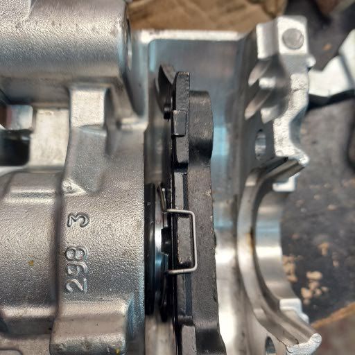

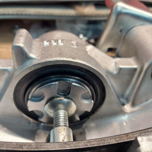

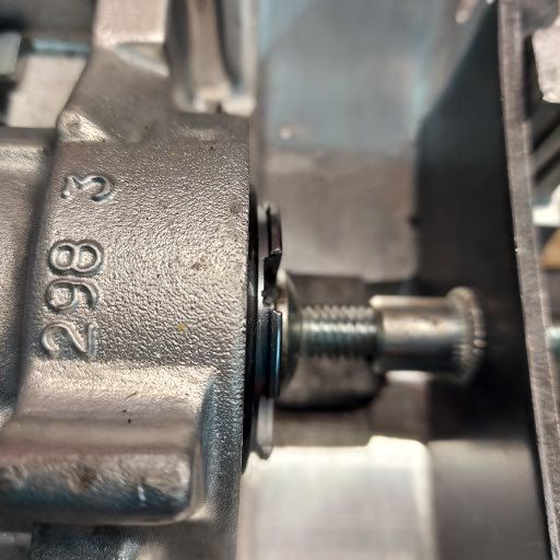

Caliper is brand new. In the past and as per the Ogre's reminder I''ve always just pushed the piston in. Haven't tried a 'gentle twist' because I don't want to risk causing damage and make the calipers un-returnable. Thanks for the suggestion. I'll attack it again in the morning.

Are you able to just slip on the e brake cam and rotate it back and forth by hand to see if anything seats after a few cycles?

You tried what Ogre said ? Lever off and gentle push with clamp? If nothing, then there's something blocked in the piston. I've rebuilt these things many times, even though most people say it can't be done! The inner part (with thread for the lever spindle) is not seating at the bottom of the piston. You need to disassemble and check; or you just need to send the whole think back under garantee, if you don't have the time/skills to open one up.
Personnaly, I would try turning the piston in with the lever in place. It might free up the stuck part on the threads? And get the piston to go fully in. You need to push and turn at the same time. If it just stops at the same place as in your photo, then it's rebuild or send back time. 😉------------------ "Turbo Slug" - '87 Fiero GT. 3800 turbo. - The fastest Fiero in France! @turboslugfiero https://youtu.be/hUzOAeyWLfM
