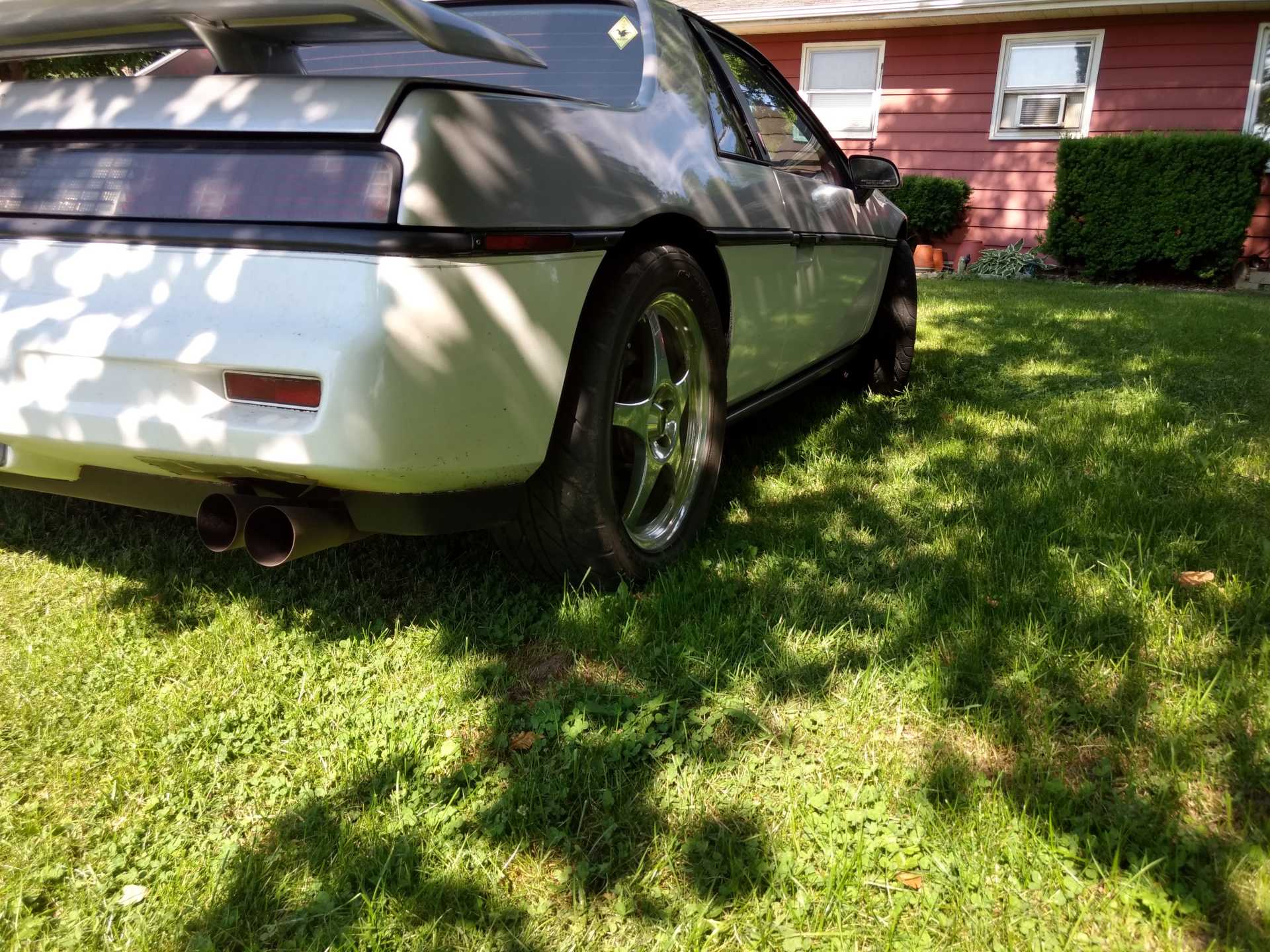

i may attempt to install the dual exhaust on my car tomorrow.its the one for the 2.5.unfortunatly it didn't come with instructions.im assuming the exhaust tips are supposed to be paralell to the ground..[that spider is distracting].so i should put a level across the opening?i don't know anyone with a fiero and the current muffler is dumping under the trunk.

IMO, you want the exhaust tips positioned within a quarter inch or so of the bumper cut-outs. I've seen them hanging lower and it looks weird.

They also angle up a bit too if they are like the V6. Make sure you have the metal heat deflectors.

Find some pictures and s of Fieros on the Forum to get an idea of how the tips should b positioned.
Here is my Formula with megaphone style stock tips.
